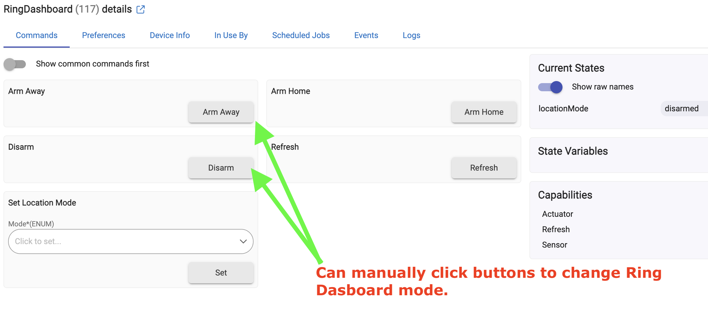

Hello all;
I have successfully configured Ring as a device. I see my for cameras in the Hubitat device list. I am stuck at the point of how I can Rule Machine to change the Ring mode? I can do this manually, but want to use a rule to have this occur at set times during the day. Any help would be greatly appreciated. Here is a screenshot of my Ring dashboard as seen in my device list;

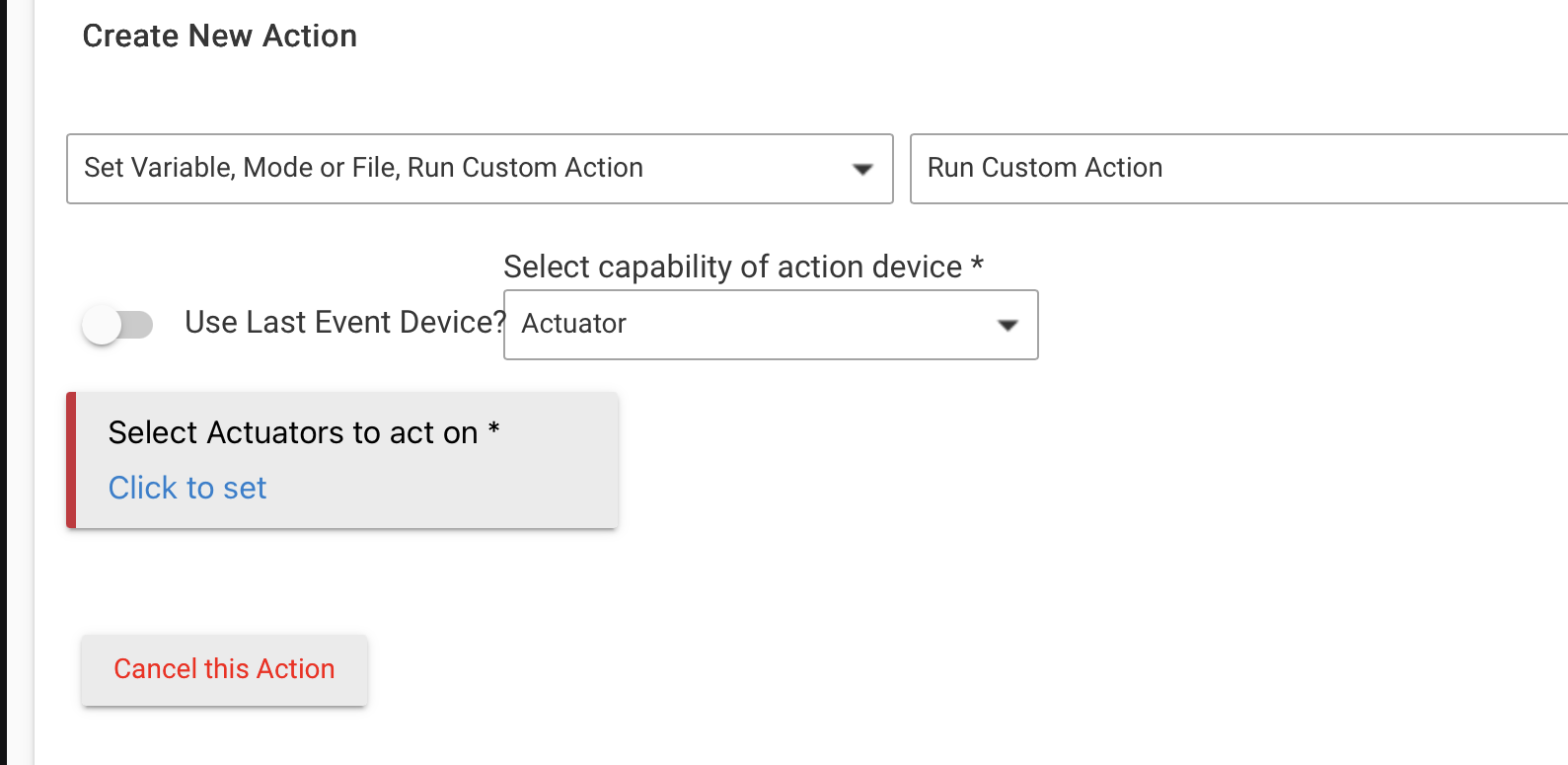

Select the device as an actuator and use custom action.
Thanks, Tom, for the quick response and concise solution. I would have NEVER stumbled across the Actuator setting on my own. It's working brilliantly!

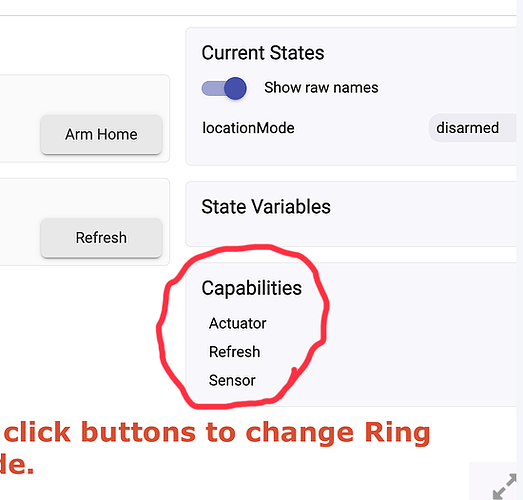

The key is to look here:
I've made use of a lot of custom actions but I was not aware of "capabilities" as a ready list of available actions.
I wouldn’t say it’s a “… list of actions”, but often a list of ways to get rule machine to show you the available actions, as it keys on the available capabilities.
