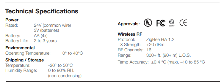

It maybe out of the operational range the manufacturer designed it to be used. (rightly or wrongly) This to me would be a poor design decision.

From a 2016 Centralite Pearl Thermostat spec sheet..... I guess they are serious about the operating temperature....
