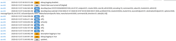

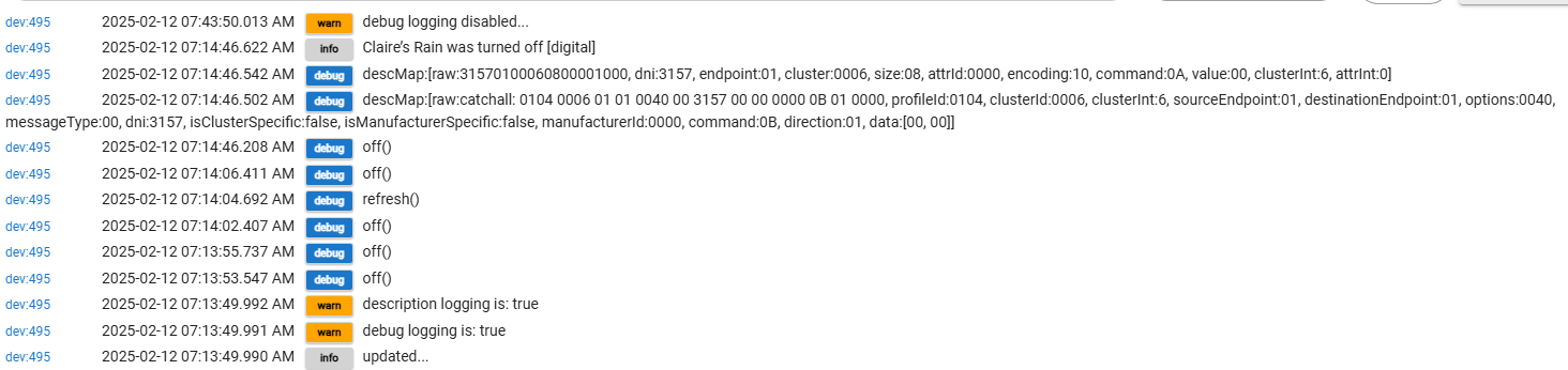

I'm at my wit's end on this. I have tried changing the Zigbee channel, the Wi-Fi channel, Zigbee power level (8 then 12 then 16), etc. and nothing I do works consistently. Just when I think it's working well, something stops responding. 99 times out of 100, if I turn debugging on for the device and save, the device starts working again.
This morning I finally had one that I was able to capture debug info.

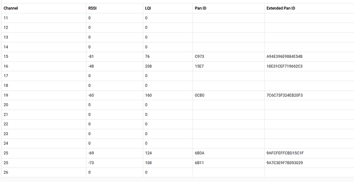

I don't know what else to do. When I scan for Zigbee channels, the ones that I've used are far enough away from my Wi-Fi channel or in one of the non-overlap and far enough away from other channels (here's my current scan).
My C-8 is currently on Zigbee channel 15 and maximum power level. I've tried power level 8, 12, and 16 on this channel.
Wi-Fi is currently on Channel 11 (least congested in my neighborhood). I have tried using Channel 1 as well (have not tried 6 but since it's right in the center, I was avoiding that one).
I have no issues at all with the C-7 (it's on Zigbee channel 16). Those devices are up and running without issues. ST must be using 19 (I have a hub keeping two smart bulbs connected to a network - that's all it does - I don't even control them, they've been reduced to "dumb" bulbs for the most part after I learned of the routing issues they have).

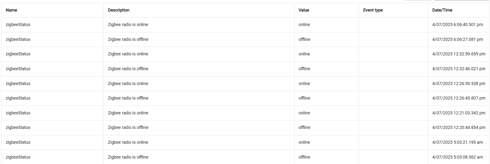

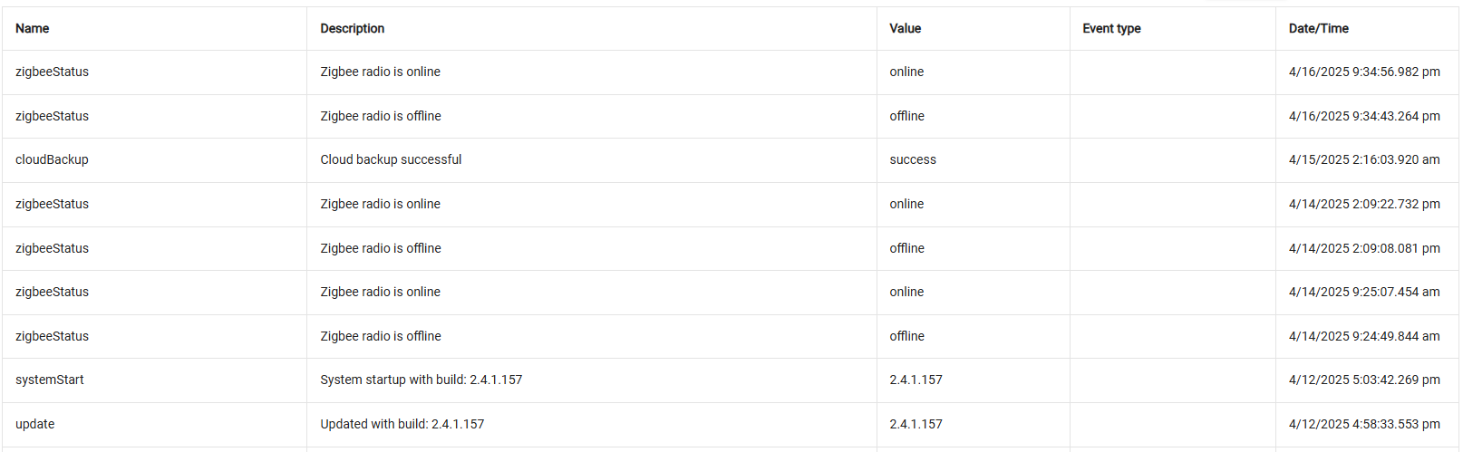

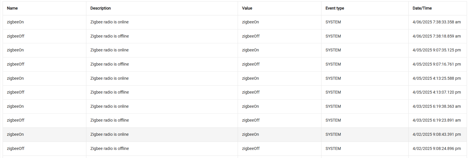

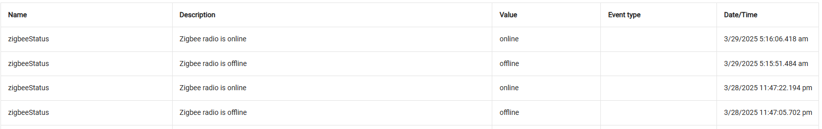

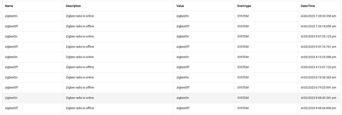

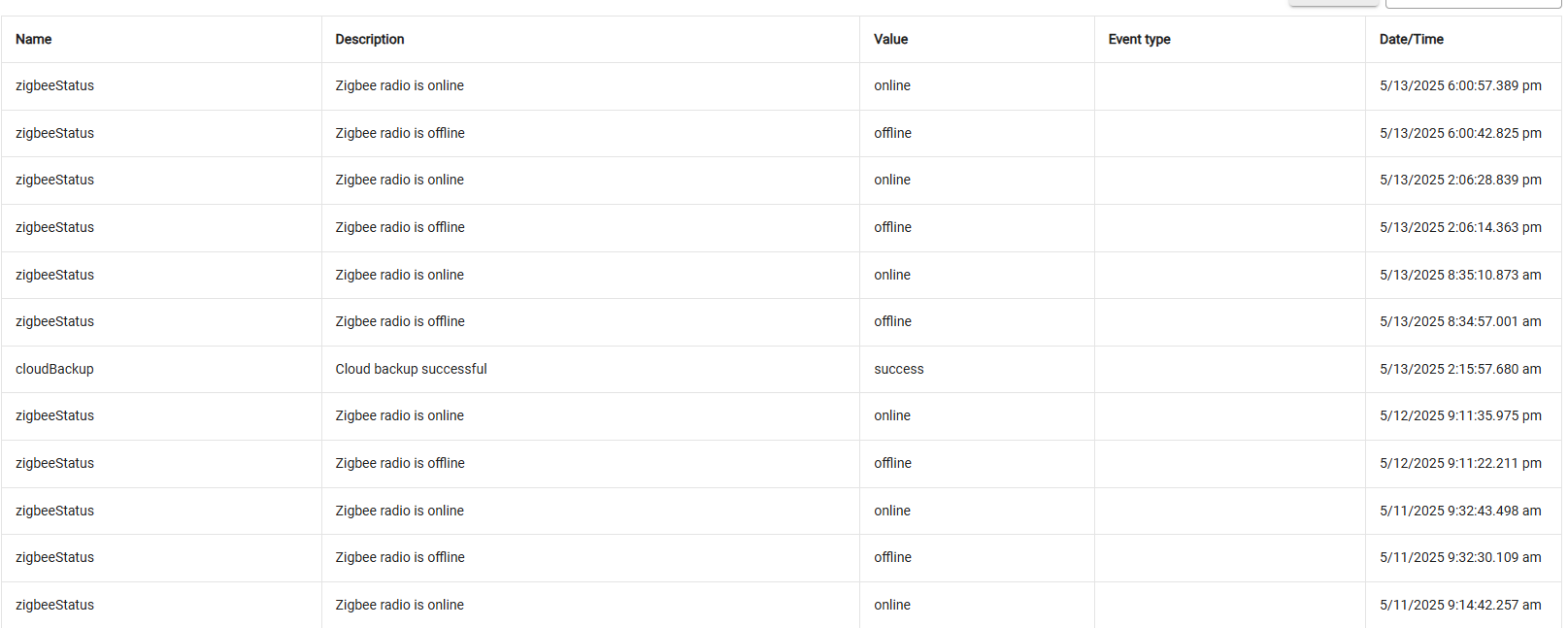

I also did some searching a few days ago (I was researching the "Rebuild" option under Zigbee, which I have yet to try) when I found someone else having a similar issue and he mentioned his Zigbee radio kept going offline and coming back. Well guess what? So is mine:
@bobbyD - what do I need to do now?

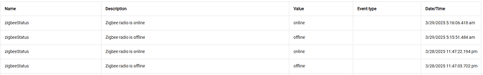

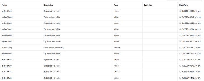

OK I lied, @mike.maxwell. Things are still pretty bad. Zigbee radio has been offline many times today and half my stuff isn't working now.

We'll Zigbee itself doesn't go off line by itself
So until we figure out what load(s) are causing Zigbee to puke the situation isn't going to improve

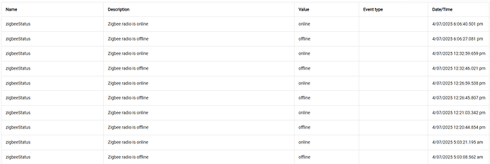

Update: Full shutdown helped nothing. Commands are not getting to many devices and the ones that do, replies aren’t getting back to the hub. I can control very little at this moment so any insight into what to do next is appreciated.

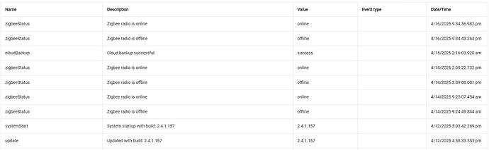

However, the radio continues to go offline and come back. What do we need to do to troubleshoot that?
Still happening.
@support_team - what do I need to do now to troubleshoot? Command retry has helped but I can tell that commands aren't always getting through and the keypad that is mere feet from the hub keeps getting booted off.

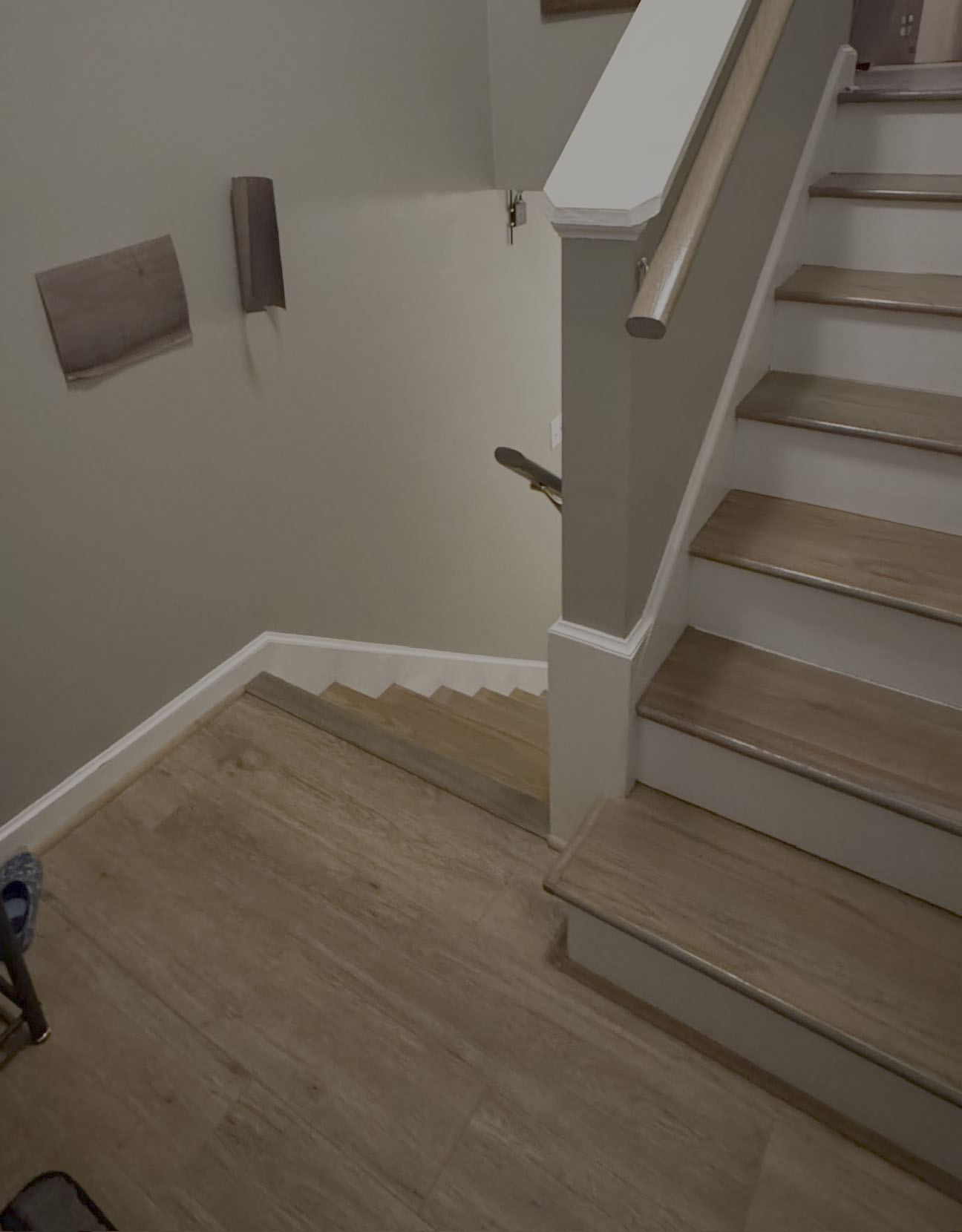

This is how far the keypad is from the hub, for reference:
