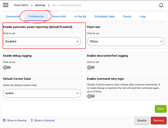

I would explicitly open each outlet’s Device details web page on the HE hub, and set the power reporting user setting to Disabled and then click Save. This should configure the outlets to not send power data for sure.
I would open the Settings->Ziggbee page. Then open the Zigbee logs and monitor them to see if any decice(s) are overwhelmingly chatty.
I do. Do you think it's worth trying?
I don't actually see that setting anywhere, using the "Generic Zigbee Outlet" driver. But there is a property for Power under the "Current States".

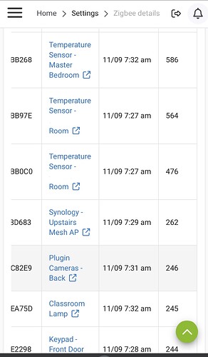

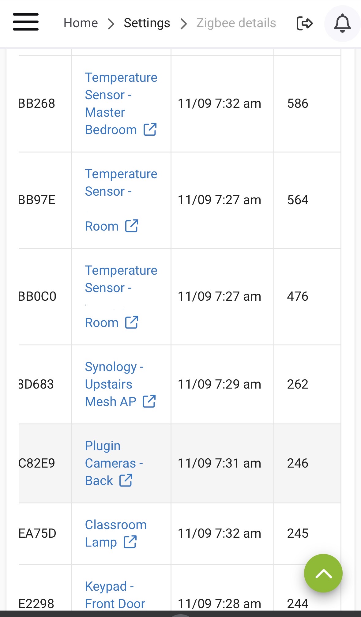

On the Zigbee Details page in Settings, look for devices that have a disproportionately high message count - that can indicate a misbehaving device that's spamming the mesh.
If you have any energy-monitoring zigbee devices, ensure those reporting parameters are set to just what's necessary -- excessive energy reporting can also easily over-spam the mesh.
So my top 3 are temperature sensors in our bedrooms. They have about 2x as much as other devices.
Below that start the Centralite plugs. They’re grouped pretty well together (182-262). Below those are my other battery powered Zigbee sensors (door sensors mostly).
These counts are since yesterday at 440pm when I updated the hub.
Anything jump out at you?
