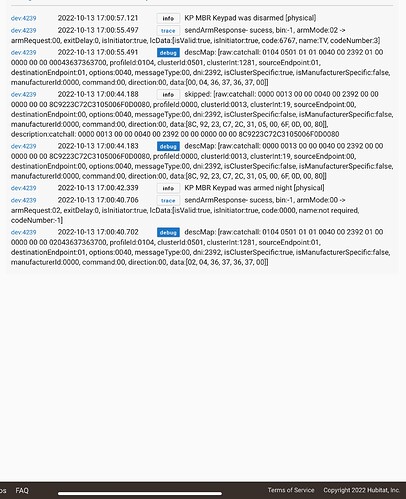

Hi, picked up a Centralite 3400 4210c V2.
Im getting a lot of catch all messages. Is that normal?

Are you expecting traffic from the device at that time (e.g., because you just armed/disarmed it or it detected motion)? If so, that looks pretty normal to me. Debug logging is enabled by default for 30 minutes after you add a device (or manually enable it), then self-disables after that time. The "info" logs are descriptionText logging and are enabled by default and indefinitely, though you can turn them off at any time. Neither will help a device that is spamming your hub with reports unexpectedly, but this all looks normal to me, assuming it's not unexpected to you.
Eventually, it will settle on just showing the "info" logs, which generally represent what events the information from the device translated into, which you may care to have for troubleshooting (but can disable if you really don't, and it's also available from the "Events" tab on the device detail page).
Cool, thank you. wasn’t sure. Thought with a proper driver there wouldn’t be any catch alls.
