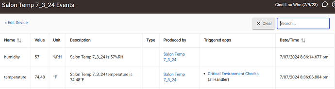

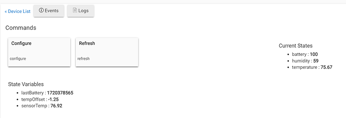

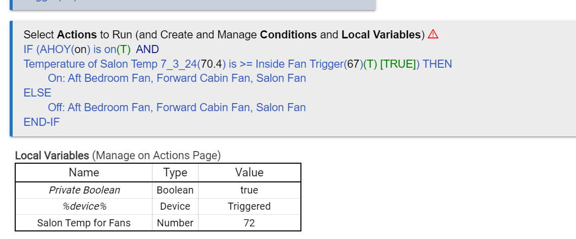

Using the Smart Things driver on 2.3.9.158, the device reports 72.3 if I look at the device in 'devices' but RM app's show the last sample (70.4) not the current value.

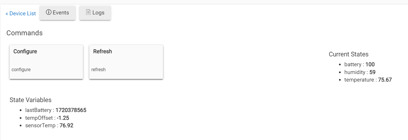

The device shows 75.68 is the current temp and is dead on.
In the app, the same device is showing the current value is 70.4.
Refresh the page, update the app - same outcome.
i have deleted the device in RM and reinstalled it, same outcome.

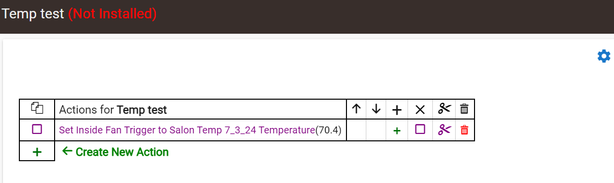

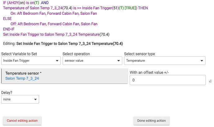

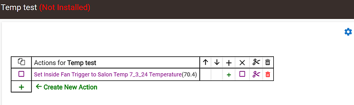

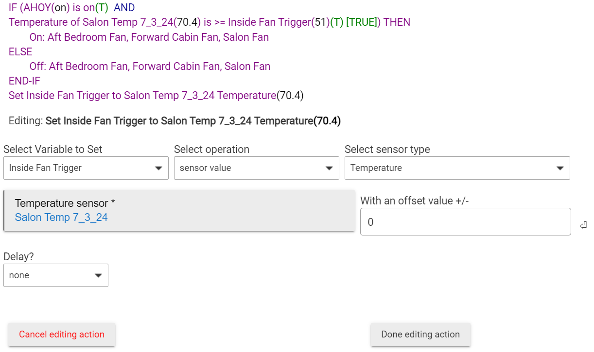

So i added a rule in the last line to set a variable based on the device, and its temp. same outcome. The rule reads a value from who knows where, but its not the current sensor value. The rule runs btw - if i adjust an offset in the app that is a global variable to tweak where i want the fans to kick on. Anyway sure not working right.

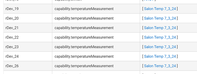

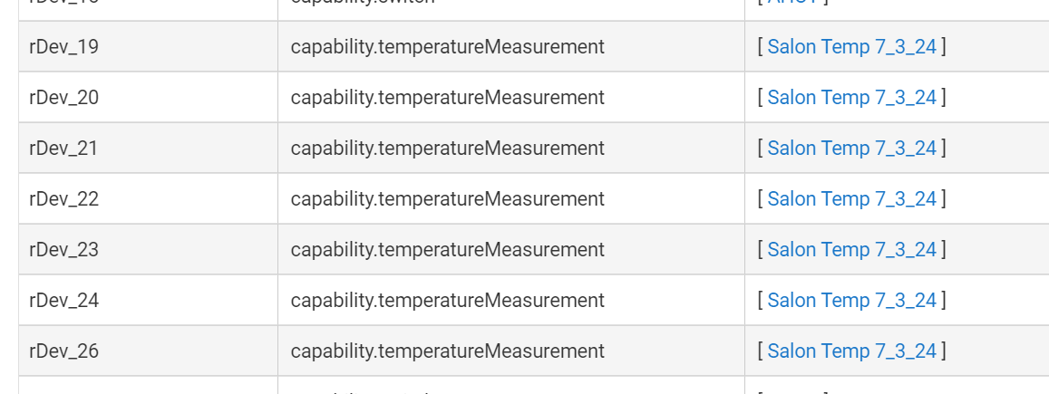

While it won't be super-meaningful, you can also click the App Status (gear) icon in the upper right of the rule, look at the "Settings" table (nothing else here matters for this, including event subscriptions), and see if the device with this name that you see referenced there is the same device you are expecting (and if clicked takes you to the same device detail page as the device you posted above).
This isn't meaningful information without knowing your entire rule (everything is cut off in your screenshot except the actions), but I suppose that's good in general.
The driver will not affect this if it's working fine on the device detail page. That's what matters. Apps don't know anything you can't see here--they just read the same values.
got me stumped. for sure, 1 device. look at the last 5 minute report. the app that controls the fans above, the app is stuck on 70.4. it's not getting the current variable handed to it right.,

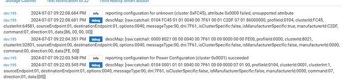

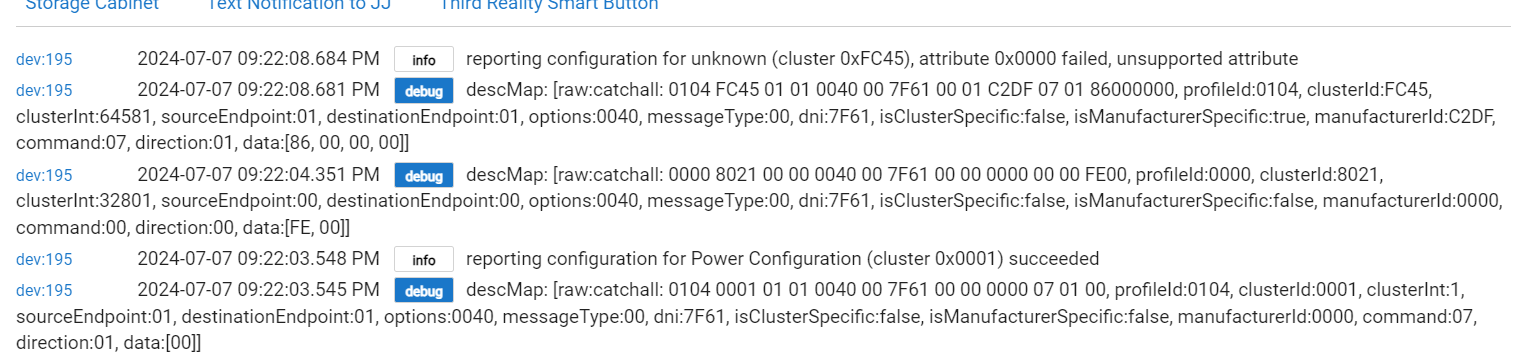

turned the log on for a while; please LMK your thoughts please. and thank you

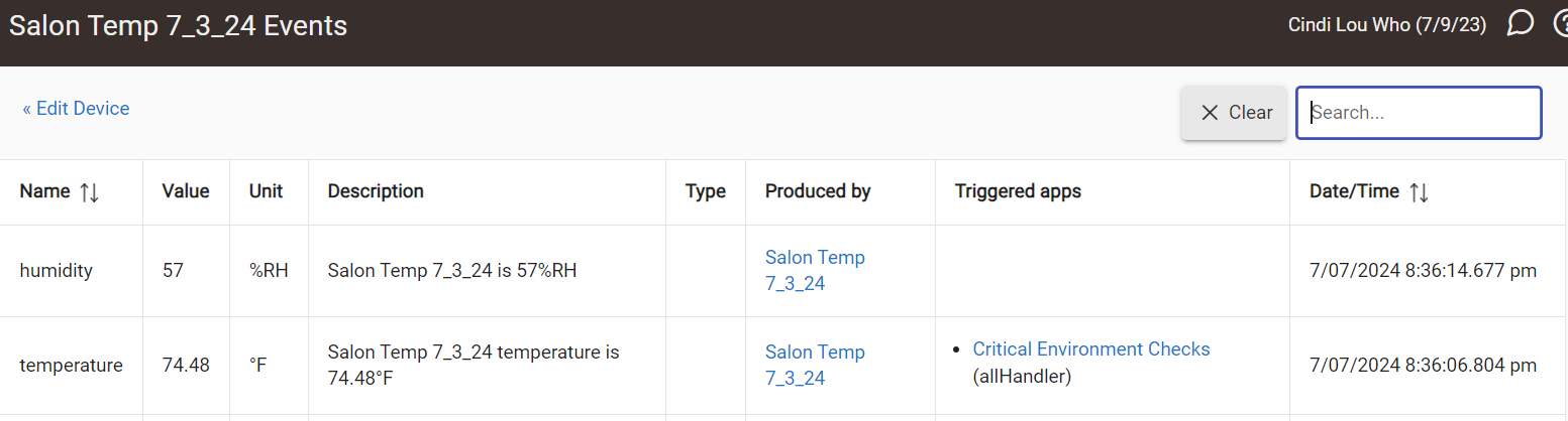

Debug logs aren't going to show you much beyond more information about the underlying Zigbee messages that correspond to the events you are already seeing. You don't seem to have a problem with those. The device detail page and Events page there is the authoritative source.

i just ran line for line what you suggested, and it appears it is linked in what i see here to the right device.
The rest of that suggestion: if you click the links for the device (in the right column), does it take you to the device detail page for the same device? Compare the URLs, in particular the numeric device ID you'll find towards the end, to be sure.

I wrote a new rule, one line, The device temp variable still stuck on 70.4 here also, this has to be a bug.
