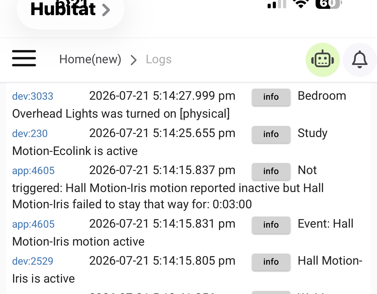

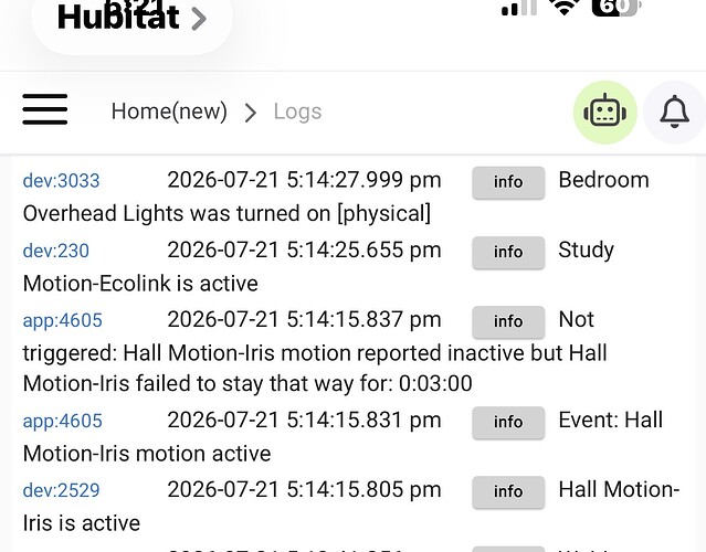

I have a Caseta Dimmer that occasionally turns on by itself. Alexa Hunches is disabled. I’m not aware of any automation that would turn this light on.
The log says “physical” but the dimmer was not physically touched. See the top line below for Bedroom Overhead Lights

Just to clarify: "physical" doesn't mean that dimmer was physically touched. It just means that the Hubitat hub didn't issue a command to control the dimmer; yet the dimmer changed. This could be because the dimmer was actually touched, or it could be because the Lutron mobile app or some other Lutron integration changed the dimmer.

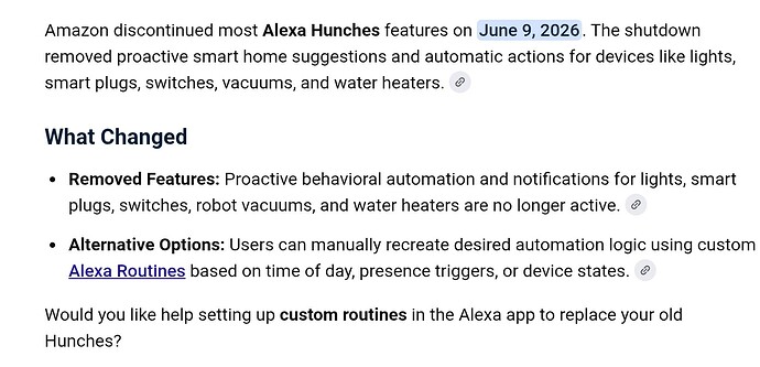

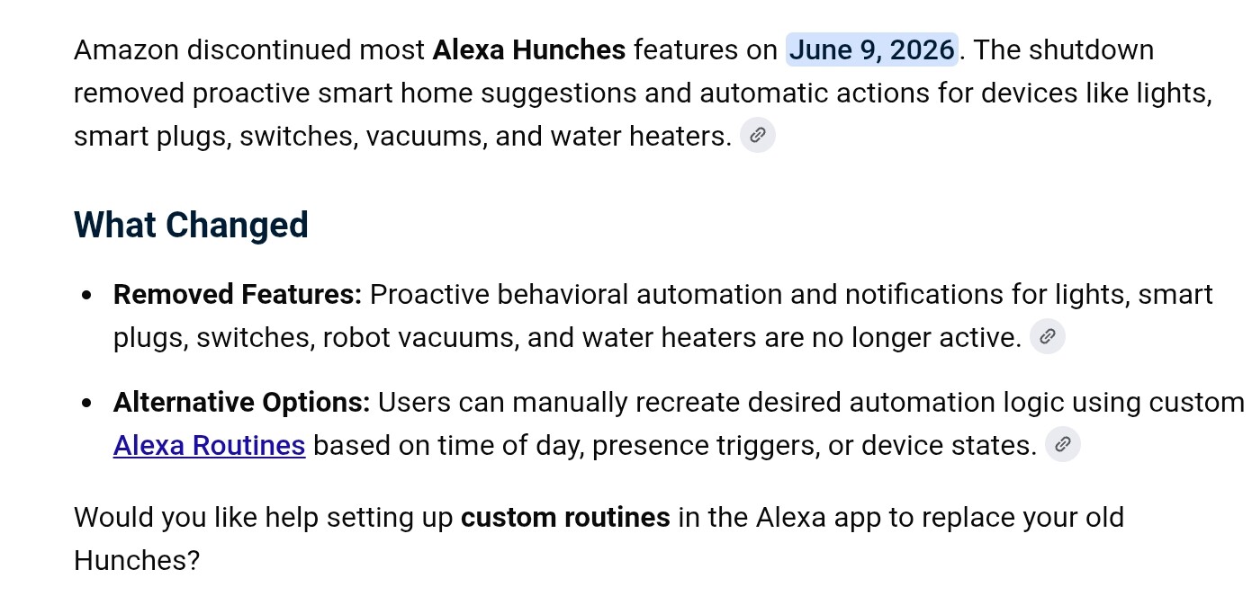

For the record, this is becoming a moot question. Proactive actions due to hunches has been discontinued. Any hunches would have had to have been created before June 9th of this year.:
