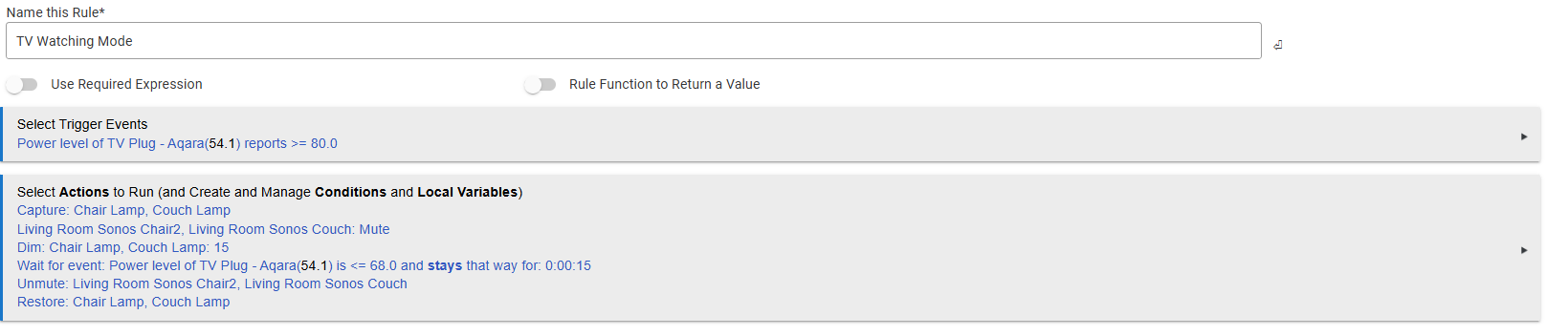

I have a rule that I have been using for some time, to run certain devices when TV is turned on, then to restore after TV has been turned off.
Everything works properly, except for the capture and restore of the two side lamps.
Logs show that everything was completed properly, no errors.
Any suggestions?

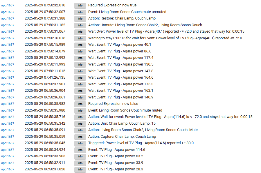

So, in the log, it looks like the rule is being re-triggered every time the power is reported. Therefore, once TV turned off, the value of the lamps that were set when the mode was started is the value they are restored to.
Suggestions?

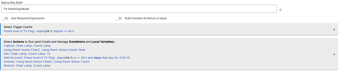

You're going to have to find some way to prevent the rule from re-triggering while you're waiting. An easy option might be adding a required expression of Private Boolean true, setting it false as the first action in your rule (or any time between then and right after the capture), and then setting it back to true after your restore.
Something like "power <= 68" would almost work but for the "and stays" (but would otherwise be easier and less sensitive to interruption) -- but won't in this case since it will take you back to your original problem when the does this kind of fluctuation that it looks like you're trying to avoid.

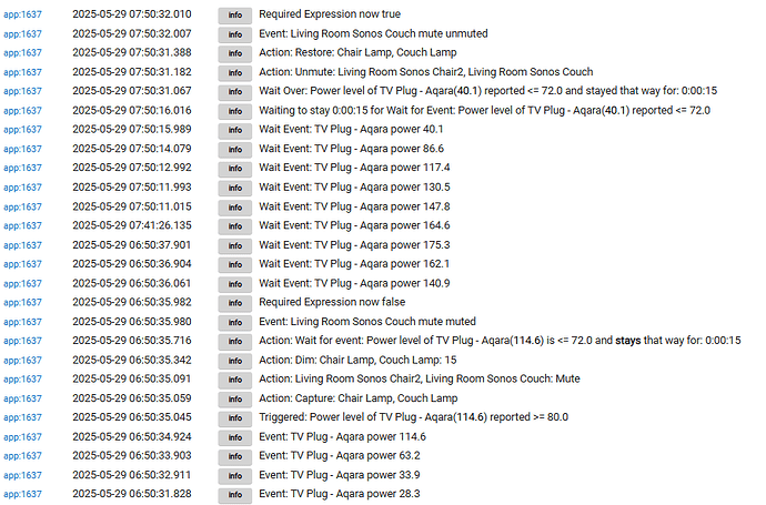

Here are the logs:
Shows that everything should have worked as indicated. Yet, the speakers did not unmute, and the lamps did not restore properly.
Next steps for troubleshooting?
Can you turn on full logging on the speaker and the lamp to see what they are reporting?
