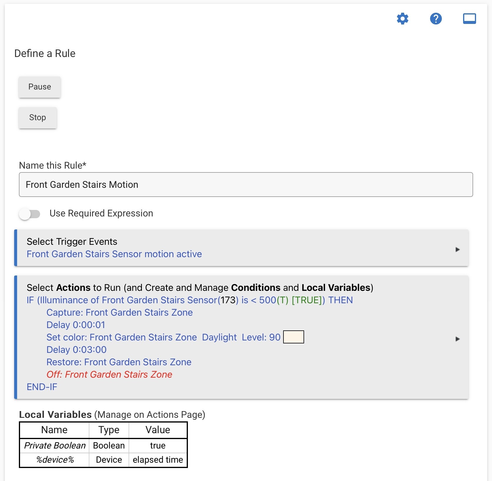

I am using Cocohue with a hue hub. I am trying to turn on a set of lights when motion is detected and to then restore it to the scene that was there previously, either lights set or off, after a short delay.
I have set the initial scene to be captured before running the rule both from the hue app and from within Hubitat, both operate the same.
What I see is that the lights do not restore to the previous scene and just stay on to the motion detected settings. If I substitute a turnoff switch command for the restore then the motion scene turns off ok.
I am very new to Hubitat so it is probably an elementary mistake. I have attached my code what am I doing wrong?

We might need a couple more details.... The Front Garden Stairs Zone, is that a group from Hue brought into HE via Coco-Hue, or something setup within HE?
Also:
  • You may want to include some additional logic in your rule to handle continued motion, or move the rule to an App like Room Lighting. Depends on the use of the area.
  • Is that "Off" command at the end of the Actions meant to be there? Seems off to be restoring the state of the lights and then appearing to turn them off...
  • I would suggest turning on Logging on the rule for all three options and review the logs when the rule runs, this can help in diagnosing issues. I would couple this with reviewing the Events for the Front Garden Stairs Zone, accessible from the Device Details page for that device.

So after reviewing a couple of other threads on the subject I have modified to make sure that the routine is only run once at a time, see below.
The device “Front Garden Stairs Zone”is 3 hue colour bulbs which is a zone set up in hue and imported into Hubitat via Cocohue.
I have turned on logging for events, triggers and actions.
The turn off Front Garden Zone command is disabled and is there so I can enable it after testing to make sure lights are not left on all night.
My new routine looks like this and I will test later when it gets darker.

So having tested tonight I captured the logs below, which unfortunately contains some noise entries (not connected to the activation);
What seems to be happening is that setting the colour outside Hubitat is flowing through to Hubitat, the bottom entries in the log seem to indicate that. I set the Front Garden Room to blue at 10% before setting motion off when they then went to daylight at 90%.
When the restore is done the dimming value is restored (moved from 90% to 5%) but the colour wasn't.
There are also two Multiple simultaneous rule execution errors highlighted in bold, which I am not sure about.

The rule is running multiple times which is why you are getting the error. From the documentation:
If the rule re-triggers while the delay is pending and the conditional action is reached again, you may see a "Multiple simultaneous rule execution error" in Logs (and the rule actions will not run as intended). Solutions include restricting execution of the rule while the delay is pending (e.g., with a required expression), cancelling the delay earlier in the rule, or using a "Wait for events: elapsed time" action instead if you want the timer to be cancelled on re-trigger of the rule.
Basically, your motion sensor is triggering again during your delay. You’ll want to either make your delay cancelable or change that section to a wait for motion sensor to go inactive and stay that way for three minutes (based on your delay in the rule).
As for the color not being restored correctly, I think it relates to changing the Room to Blue, but Hubitat not having enough time to poll the bridge to get the correct color of the Zone (which your rule captures). It looks like the dimming percentage got updated via the Eventstream in CoCoHue, but setting the Room versus Zone is why the color did not. I'd suggest fixing the multiple rules issue first then testing again, but setting the Zone the correct color (rather than the Room).
The other thing to test is does the rule capture and restore correctly when you set the color of the Zone via Hubitat. One thing I can suggest is to potentially only use the Hue App to configure Rooms, Zones, and Scenes. Then import all of them via CoCoHue into Hubitat and let Hubitat control. Especially for color changes, have either Hubitat set the color of the bulbs or utilize Hue scenes. If you want manual control of stuff, look to button devices or voice activation (Google, Alexa, Siri) rather than the app.
@bertabcd1234 might have some other ideas as well that can help with both this rule and "best practices" with Hue devices.
So I have done a number of modifications to the code and will know later if the two errors are resolved or not but are not seeing any issues yet.
I have also been doing some simple tests. I have set the lights for the Front Garden stairs zone from within Hubitat, to violet. I then created a test routine to capture, turn those lights red and then restore. That does not seem to be doing the restore the lights end up a shade of white. I have run this routine a number of times all with the same result.
I also tried setting the zone in the Hue application and watched the status of the zone in Hubitat. After 10 mins the zone had still not changed the attributes for the new colour and lights ended up a shade of white.
The test routine is shown below
An output is shown below.

The log indicates why the end result was a white color. Right before your test switch flipped, the zone was reading CT with a color name Polar. I’m guessing this is the color that the was captured and restored. It looks like Hubitat is seeing your bulbs as White Ambiance rather than Color. What type of hue bulbs are you using?
As a test to make sure capture and restore are working properly, try setting the color temperature via number in Hubitat. Set the lights to 2500 and have the rule change them to 6500. This should work the way you want. Assuming that works, we can troubleshoot color next.
Thanks I will try that. My bulbs are Hue Uk e27 bulbs so nothing fancy. There was no obvious change in the physical light colour before it turned Red.
Thanks really helpful, having taken your suggestion I created another test rig that set the lights to 2500, captured them, set them to 6500 and then restored. I ran it a few times and that worked as I would expect in that the restore went to the correct temperature and dimming level.
I then substituted the set colour temperature for set colours (Blue and Red) and that consistently didn't work, giving me a white colour at the original dim level.
As you say the system seems to be interpreting my bulbs as white ambiance.
So I looked at my settings for the bulbs and they are all CocoHue RGB Bulbs and yet the status says colorMode : CT. is that correct?
Current States
  • colorMode : CT
  • colorName :Incandescent
  • colorTemperature :2500
  • effect : none
  • hue : 12
  • level : 50
  • lightEffects :{"0":"None","1":"Color Loop"}
  • reachable : true
  • saturation : 66
  • switch : off
In the HUE app it shows the bulbs as being
Two are:
Light type Hue Color lamp
Manufacturer Signify Netherlands B.V.
Model LCA001
Hardware Platform 100b-112
Software 1.104.2
and
One is
Model LCT015
Hardware Platform 100b-10C
Software 1.101.2
Yes, "CT" means "color temperature," and id you just set them to 2500, that is the correct mode for them to be in (as opposed to RGB id you did a setColor()).
Thanks for the feedback, that status info was after I set the colour to blue and then red, though. If the system is treating my bulbs as white ambiance can that be changed or is a restriction?
How are you setting them to red? But yes, this would explain what is being captured regardless.
