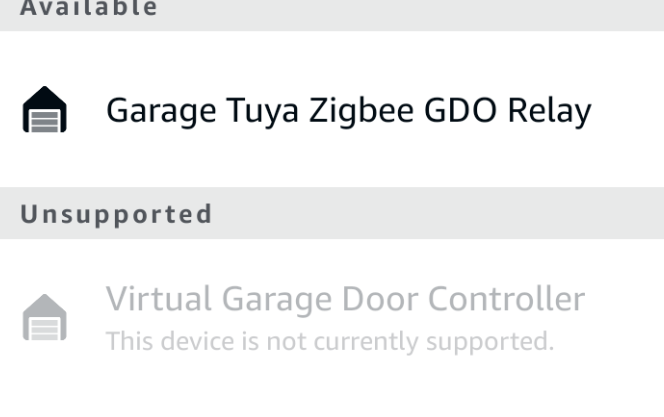

Between the two devices, the Capability of Actuator is non-existent on the Virtual Controller. But the Capability GarageDoorControl is there. Would that me the reason Alexa is barfing on this? Here's my screen - note the greyed out "unsupported".
I use the Zooz garage door app and the virtual garage door has these capabilities:
		capability "Actuator"
		capability "Sensor"
		capability "Contact Sensor"
		capability "Door Control"
        capability "Garage Door Control"
Works fine sharing to Alexa for me.
What driver is your virtual door device using? If its a custom driver you can just add capabilities to it yourself to see if that fixes it.
If you want a device driver to allow a device to do something, they basically need the actuator capability:
is that capability with "Garage Door Control" or capability "GarageDoorControl"?
I'll fart with choices and see if I can dislodge.
thanx
Both will work, HE ignores the spaces within the string when parsing the capability name.
You will need to implement the open() and close() methods - call the on() and off() functions there and send a 'door' event :grin:
door - ENUM ["unknown", "closed", "open", "closing", "opening"]
