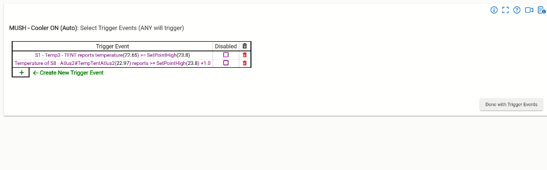

Hi,

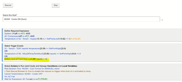

seems to be a big in one of my rules. I went into the rule to make a change and noticed that when i clicked in the trigger edit section the current triggers were greyed out and it was prompting me to select a device for a new trigger. There was no "Cancel Trigger Event" button visible. The only way forward to select a random device for a trigger and click done. Once done the trigger shows up on the main rule page, but its not visible in the trigger edit section.
Any suggestions?
No errors in log.
I tried cloning the rule and the cloned version does the same. Restarting hub has no effect.
Two easy things to try:
  1. Update, save, go to rules app itself and check for broken rules and also update all rules there.
  2. Delete the 2 triggers you can see and repeat 1) above.
I had similar issues before.
