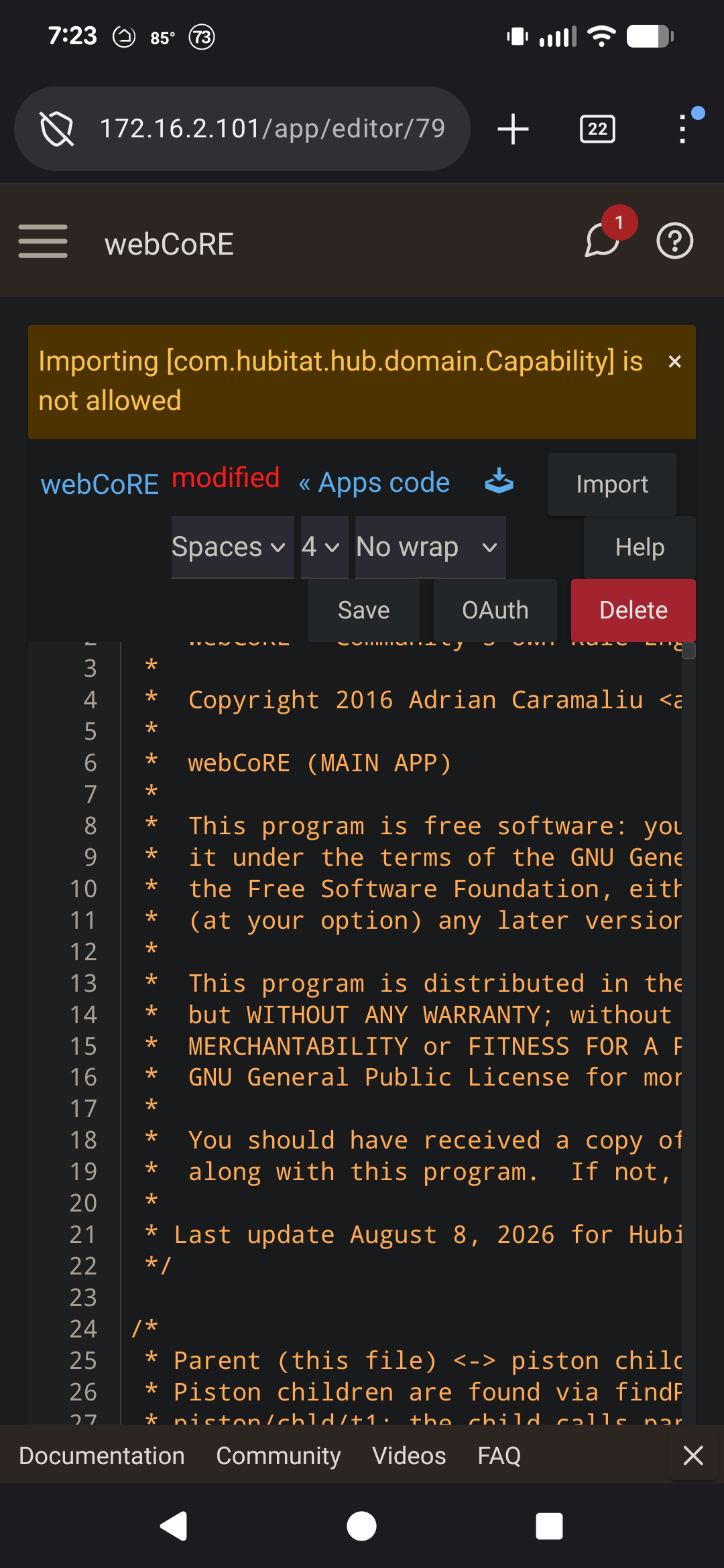

Can't update
I can't find any other bug reports pertaining to this. Hopefully someone can help.

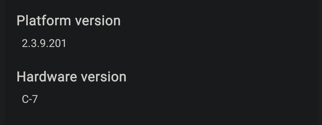

From your screenshot, you appear to be on an exceptionally old platform version. I would first suggest going to Settings > Check for Updates and updating your hub platform version (or, if you don't want to do that for whatever reason, sticking with whatever version of webCoRE currently works for you; I imagine this is the problem).
On a related note, it it is often helpful to share your platform version from Settings > Hub Details. There were just enough clues in this one, though. :slight_smile:

No, you can use the Diagnostic Tool to revert to several of your recent platform versions (or an endpoint to download the latest hotfix for a specific one if needed for some reason, e.g., it fell off that list), and you can save a matching hub backup yourself (hub backups do not restore the platform version; it's just a backup of your database, including custom app code, at that time -- among other things).
But I agree with the posters above that knowing more about your specific problems would be good.
