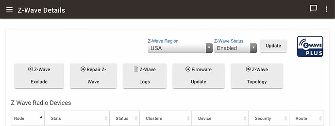

What country are you in? It’s possible that the Z-Wave radio is set for the wrong region, and can’t talk to your devices, or that the Z-Wave Radio is not enabled. See the Z-Wave Details page.

THANK YOU so, so much!! Seriously, I didn't realize that setting was there (I guess I thought it came with the settings for the country it was shipped to - my bad, not the hubs). When I checked, I found it was set to Australia (and I'm in the US). I looked up the Zwave specs for each country and they are entirely different spectrums that don't match up.
When I switched to the correct country (I rebooted, for good measure), I was amazed at how well it paired my Zwave devices. It is so much better than previous hubs I've used. The general exclude feature saved me, too. I have of the finicky Iris/Centralite dual band zigbee/Zwave repeater outlets. I've not had those setup correctly with the repeater working for a few years now. I couldn't get them paired again and couldn't get them excluded, no matter how hard I tried. I tried to pair them, and the first time it didn't work. So I used the general exclusion for one outlet putting that outlet in the Zwave pairing mode and it almost immediately found and excluded it. I unplugged it, plugged it back in, started the HE in Zwave pairing, put the outlet in Zwave pairing and boom - found it! I did this with each one in turn and it worked.
