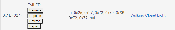

Ran an experiment on the z-wave switch that was marked as FAILED:
  1. Tried the replace option, which gave me an error message
  2. Instead went to devices/discover devices/z-wave/inclusion mode
  3. Pressed the paddle.
  4. Device was immediately discovered and added to the mesh. So now I have the same device twice :slight_smile: as FAILED and as OK, the latter which responds fine to commands, etc.
  5. Removed the FAILED one.
Would be nice if Replace worked, would help with not having to track down all places the device needs to be added back

BTW, it turns out the Remove button on the zwaveinfo page is a no-op. So I ended up with two devices called Walking Closet Light and had to go trough some hoops to delete the bad one: it wanted to go through the exclusion mode process which was not possible in this case. So had to change the device type and the device DNI to delete it as suggested here.
Unfortunately it didn't delete the device from the zwave page. Is there a way to delete it from here:
A force-delete-no-exclusion-mode option would have been nice.
you nned ti get rud if that ghost devices can definately cause issues. with zwave,, you can try excluding the orignal device.. or hitting refresh and discover a few times till remove comes up.. usually works better immediatley after a hub reboot

That doesn't alter the way the ZWave microcode out there on the ZWave Radio works. The REPLACE feature does not exist until there's a device in FAILED state. That's just the way SiLabs invented this and has been true for at least 4 years back to the identical feature that was available on my Staples Connect in 2016. It's how it works when you buy a ZWave Radio USB stick and use SiLabs PC Controller too.
