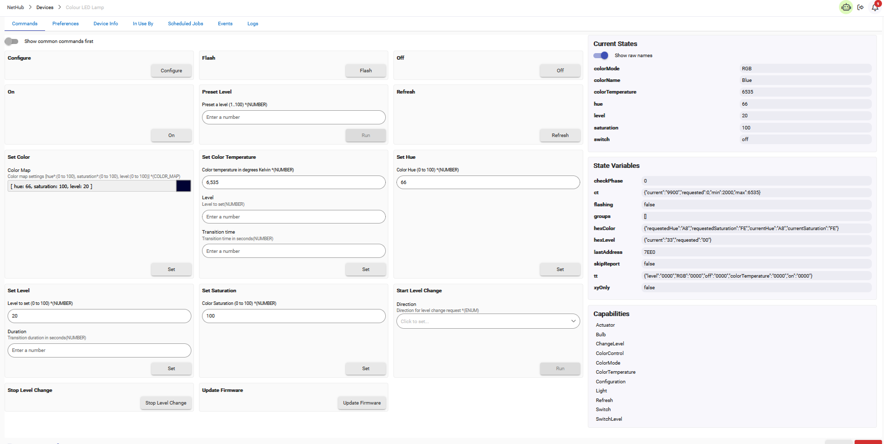

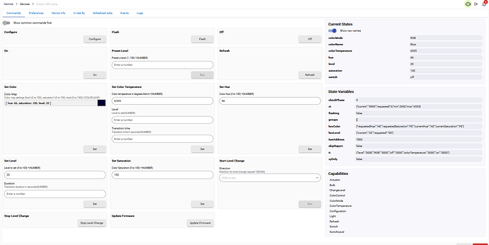

Its been a low priority issue, but now I would like success. No matter what colour I specify for my colour bulb to be when turned on, its starts with the last colour it was displaying before it was turned off! It will then transition to the colour I specified over a period of 1 second. I would have thought it would be possible to nominate a colour for the bulb immediately it illuminates, almost like a 'staging or pre-emptive' colour with zero dimming level. Then, once dimming is set to a non-zero number it would behave with the colour requested. Any ideas, or am I too fussy.

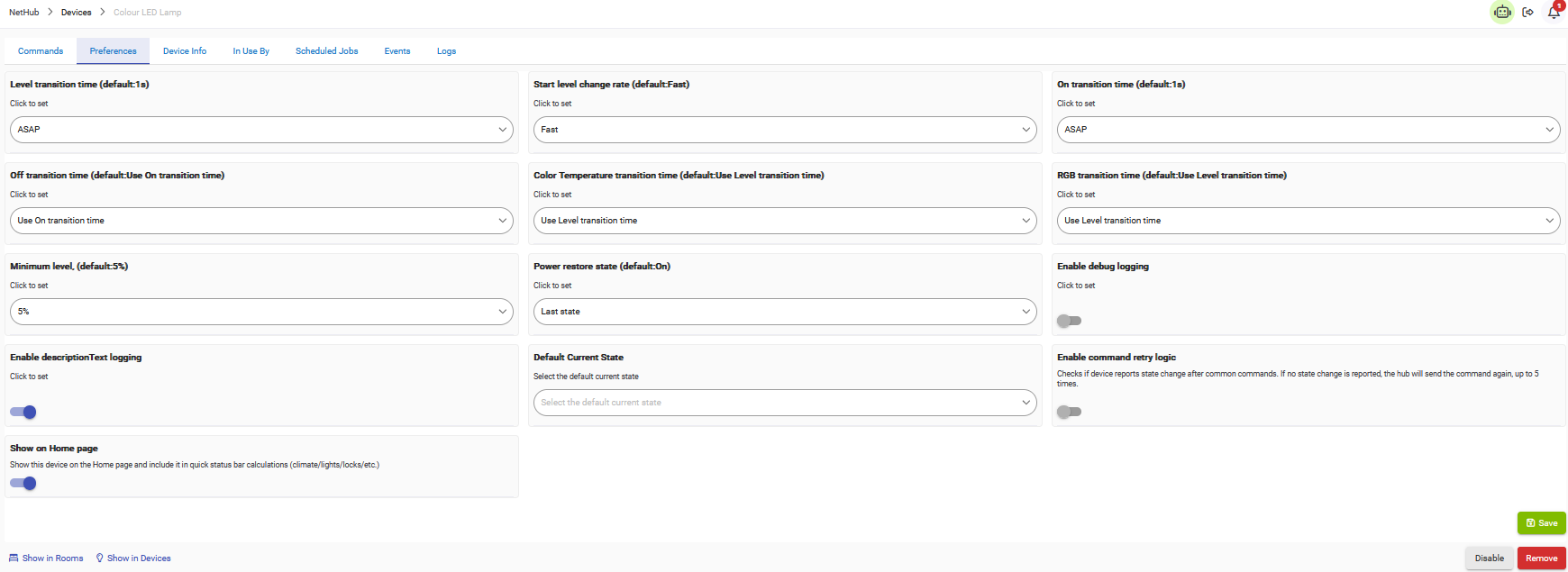

What is the exact bulb model number, and what driver (type) is it using? Screenshots of your settings for the bulb preferences also would be helpful.
It is almost impossible for someone to give you advice without knowing this basic information. Some bulbs can do what you are asking, others cannot.
I am running this bulb on a C7, 2.5.0.159,. Its a Phillips Hue RGB Colour bulb but have discarded the packaging long ago. The specs in the Devices info says it is a Signify LCA006. its using the driver "Advanced Zigbee RGBW Bulb".

Have found an interesting behavior, when I move the color bulb into the same room as my Hubitat I dont seem to get the residual previous color initially illuminating before the commanded desired color. The further away from my Hubitat, the worse the residual color seems to behave. Am trying to ascertain the reasoning to this behavior before changing drivers.
