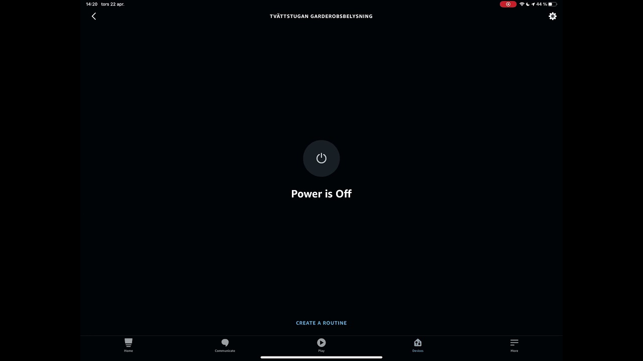

This is what happens when I’m trying to edit a switch in the Alexa app…
As you can see, I only have this problem with switches.
