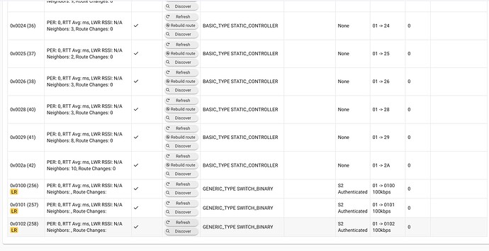

I read about ghost nodes and I seem to have a few. In the Z-wave details I've clicked refresh a bunch of times and don't get the option to remove them.

Looks like you indeed have many ghosts, so that is likely part of the issue. I would suggest switching to Z-Wave JS if you haven’t already - it will make it easier to remove the ghosts directly from the hub. Once with JS, click « Refresh » again until a « Remove » option appears.
I had to do the same last night. I have been replacing my Red Z-Wave's with Blue mmWave's and found even after excluding I had two ghosts that couldn't be deleted. I switched to the Zwave.js and they both deleted fine.
That did the trick! Thank you!
