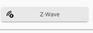

Try pressing three times On quickly followed by three times Off quickly on the switch, and see if that does it.
Also, you don't need to go through the "Find by brand" process. You can just select "Add Device", and then "Z-Wave" and then "Start Z-Wave Inclusion."
