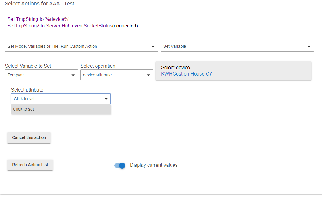

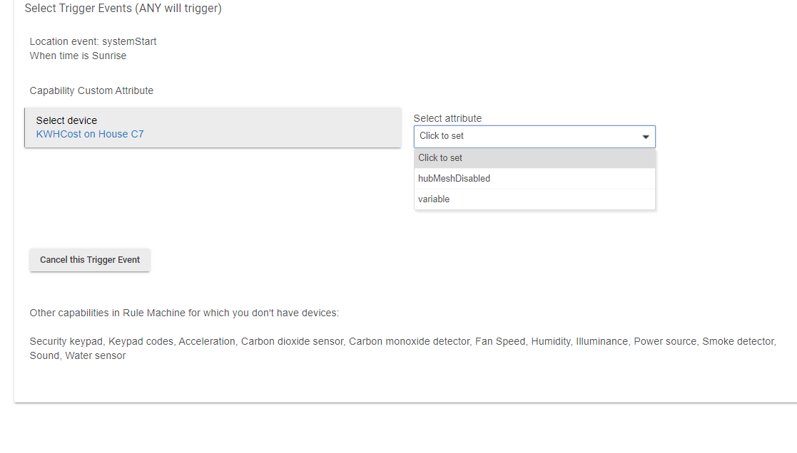

@bravenel I thought I had done this but I was looking at my Hub this morning and I realized that I can't access the values of my Hub Variable connectors on other hubs in RM5.
Screenshot below is a Decimal Hub Variable that stores the current KWH cost. The drop down should show device attribute hubMeshdisabled and Variable. As it does in RM Legacy, see next screenshot
I have three hubs, KWHCost is a Hub Variable on the House C7 and I cannot use it's value in RM5 on either of my other two hubs, I can use them in Dashboards and in RM legacy. Anyone Else?

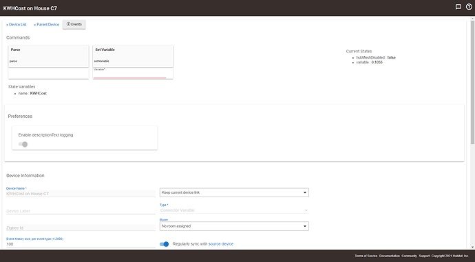

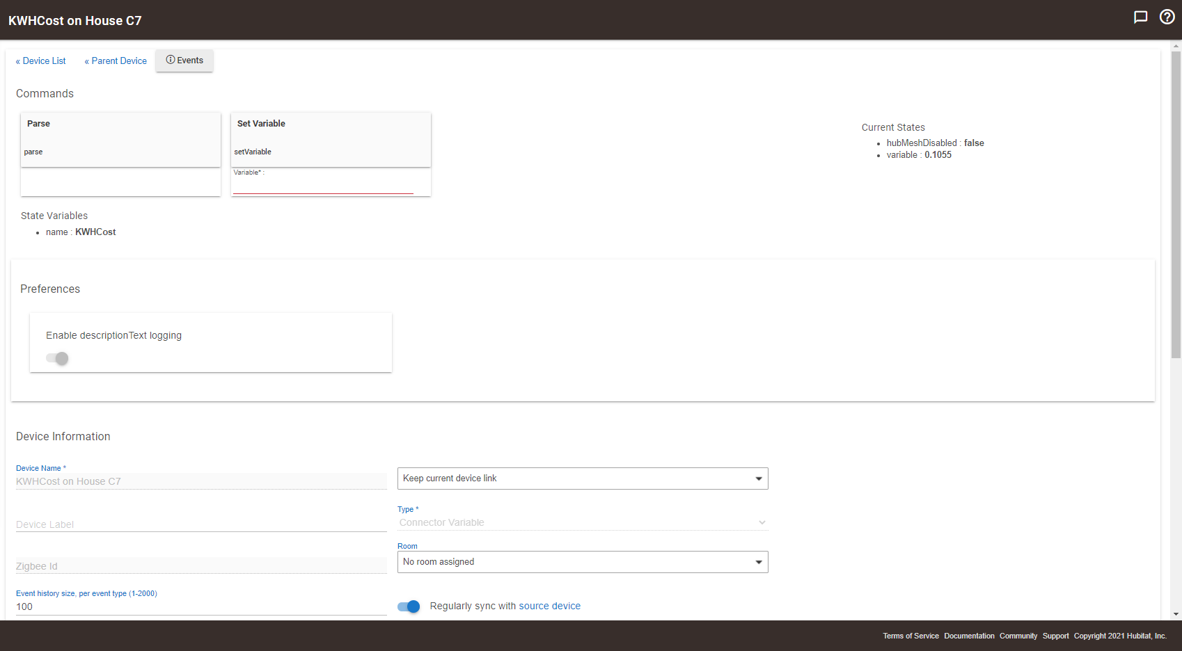

So you're saying this is a device connected by Hub Mesh and it isn't showing its attributes on shared hub? Please show the device page of the shared device (not the original one).
Yes that is correct

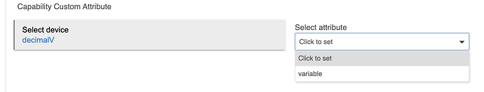

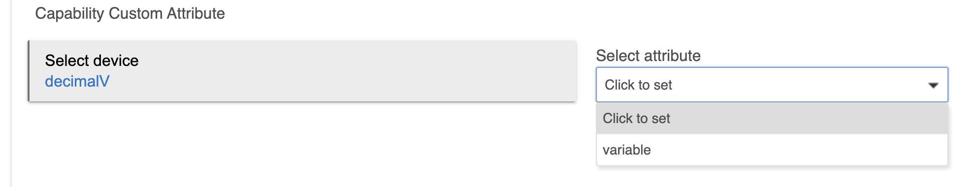

Would you begin a rule in Rule 5.0, and select Custom Attribute for a Trigger Event, select that device, and see if it shows any attribute available, like this:
It does.

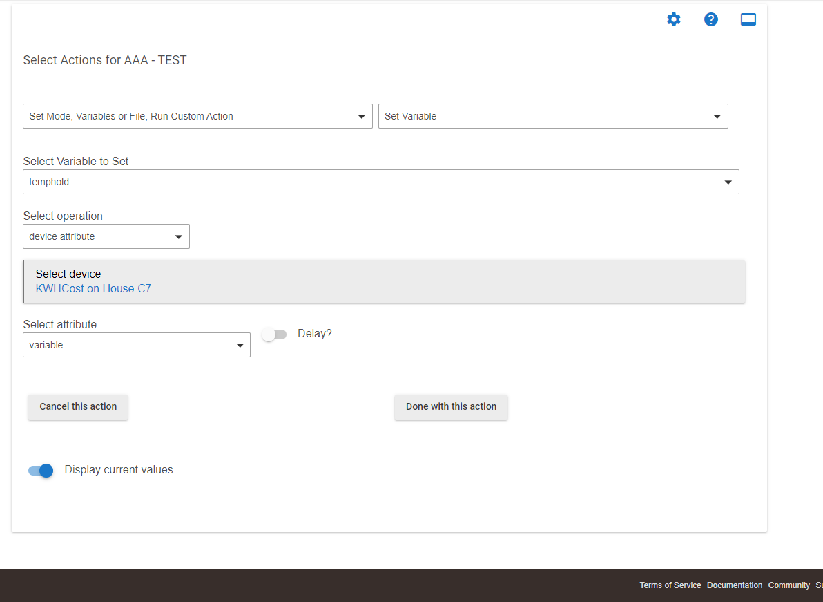

What is the type of the variables you are trying to set above, Tempvar, and temphold?
Both are decimals.

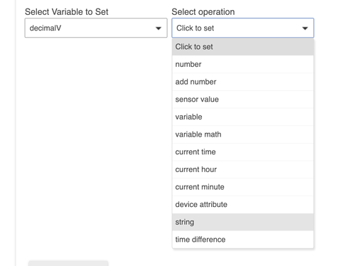

But 'variable' is a string, and you can't just cram a string into a decimal. If the variable attribute is the string representation of a decimal value, put it into a string variable first, then use the string conversion into a number operation.

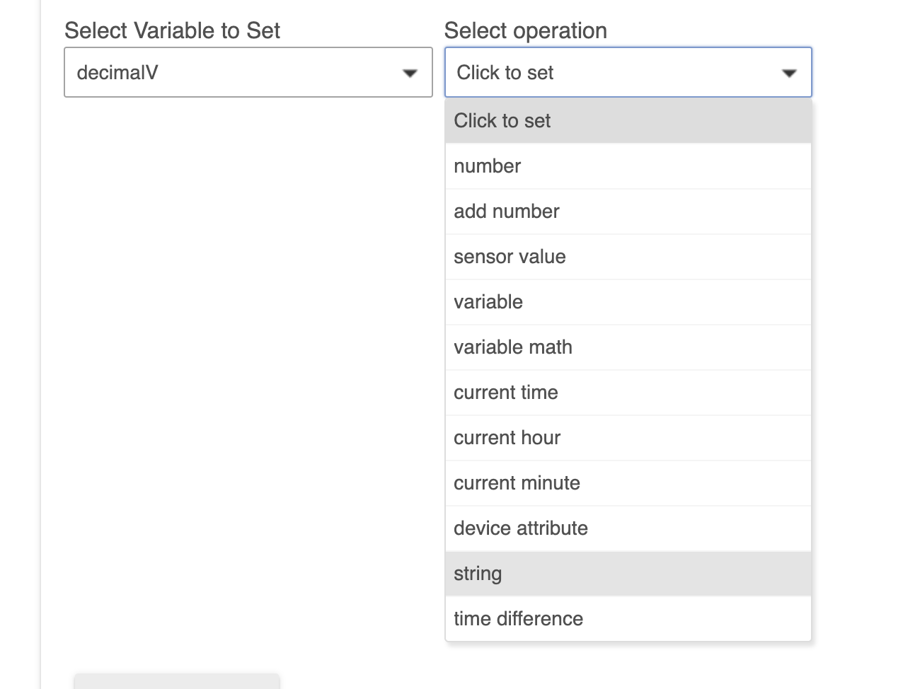

I'm talking about the 2 step approach I described above, of first setting the 'variable' attribute into a String variable, and then using the 'string' operation for setting a Decimal variable to that value. The latter has a bug.
I think we are talking about the same thing. Below is what I ended up with and it works. When setting up the second line of the rule in the screen shot below there is a slider that can be used called "variable numeric string". If you use that slider you can just select the string variable(TmpString) instead of putting it between %%. However, that method throws an error in the log and will not execute.
