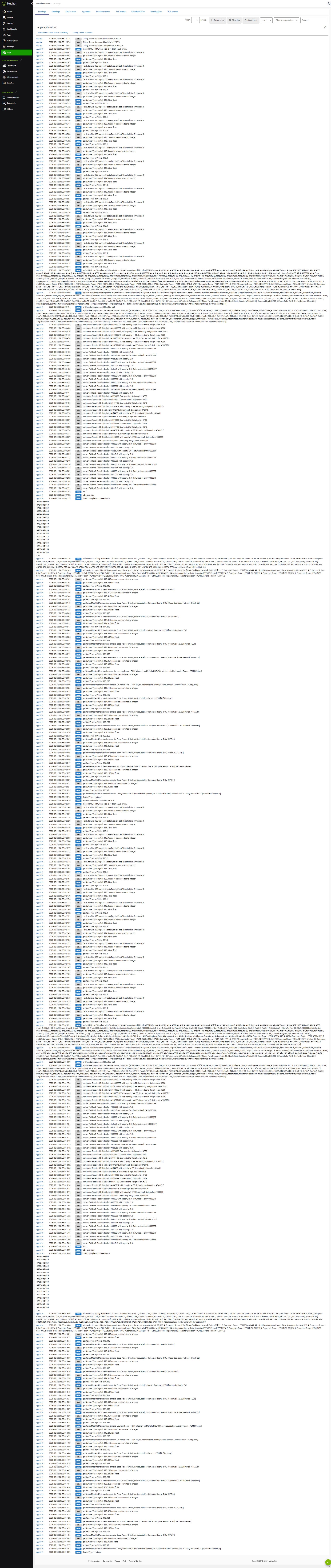

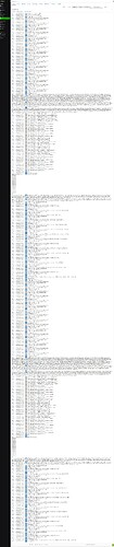

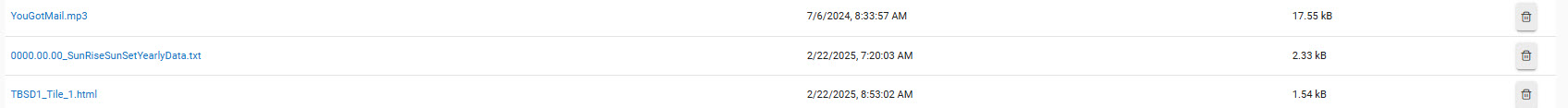

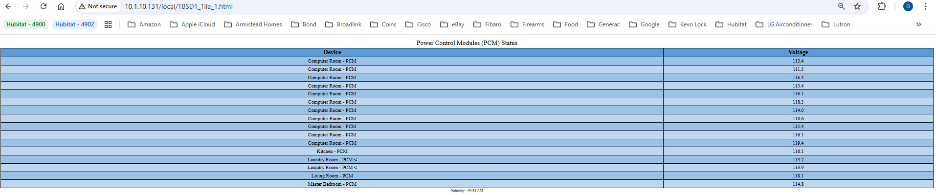

I believe I have completed all the app steps necessary to create my 1st tile; however, I do not see the output of the app. I am thinking that should be a device in the dashboard Add / Remove device list that I can add to the EZ Dashboard list. Maybe this is my mistake? I must be either missing the concept or a step somewhere? I do see an error (in the log below) that may be an issue.

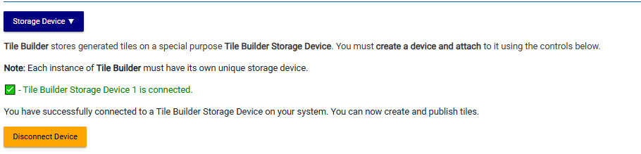

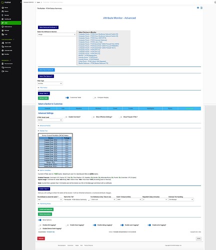

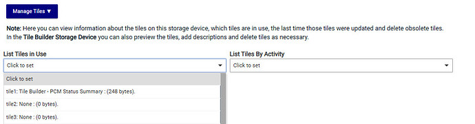

I am providing multiple screenshots that may rule out some questions about the app's installation while helping someone provide me guidance. Hopefully Gary may also pick up on this thread as well and provide some insight.

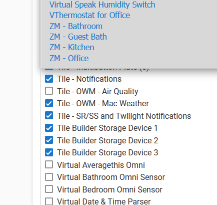

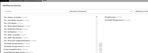

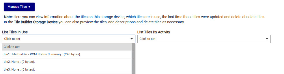

Thanks for responding! I think that is the issue. The only device I see in the Dashboard list of eligible devices that I can add (left column) is the Tile Builder Storage Device 1 (default name for the app database). I did not add that by the way.
I was expecting to see an item in that same dashboard list the tile I built (tile 1) named Tile Builder - PCM Status Summary but it is just not there. I don't see anything to add but the app database.

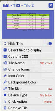

I don't use any HE Dashboards - but on my favorite dashboard HD+ - you add Tile Builder storage, then, in the dashboard you can choose the tile you want. Here is a random snip I grabbed to show you:
The tile interface in my HD+ dashboard (I use a 29" portrait display with an Android Emulator running to use HD+ btw)
So, in my case I just copy one tile to another and change the 'tile#' field to choose what to display. Give that a try?

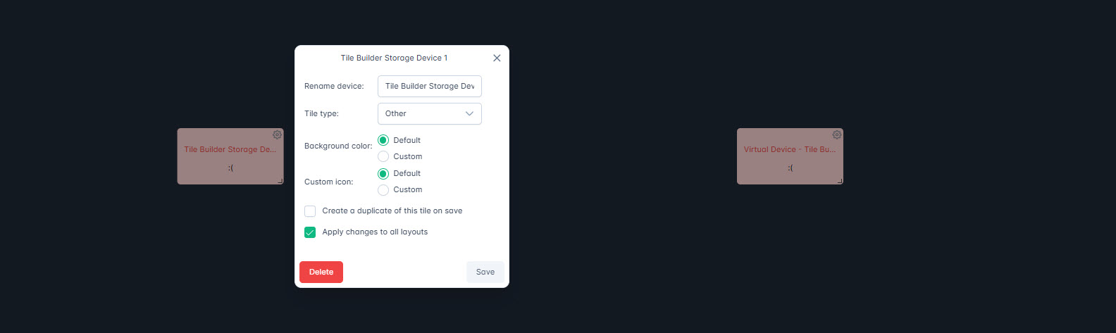

Per your suggestion I added the Tile Builder Storage Device Driver back to the dashboard. I thought after making other changes it may make a difference. Unfortunately, no luck. There is no ability to select anything but "Other" for the Tile Type. I just get the sad icon LOL.

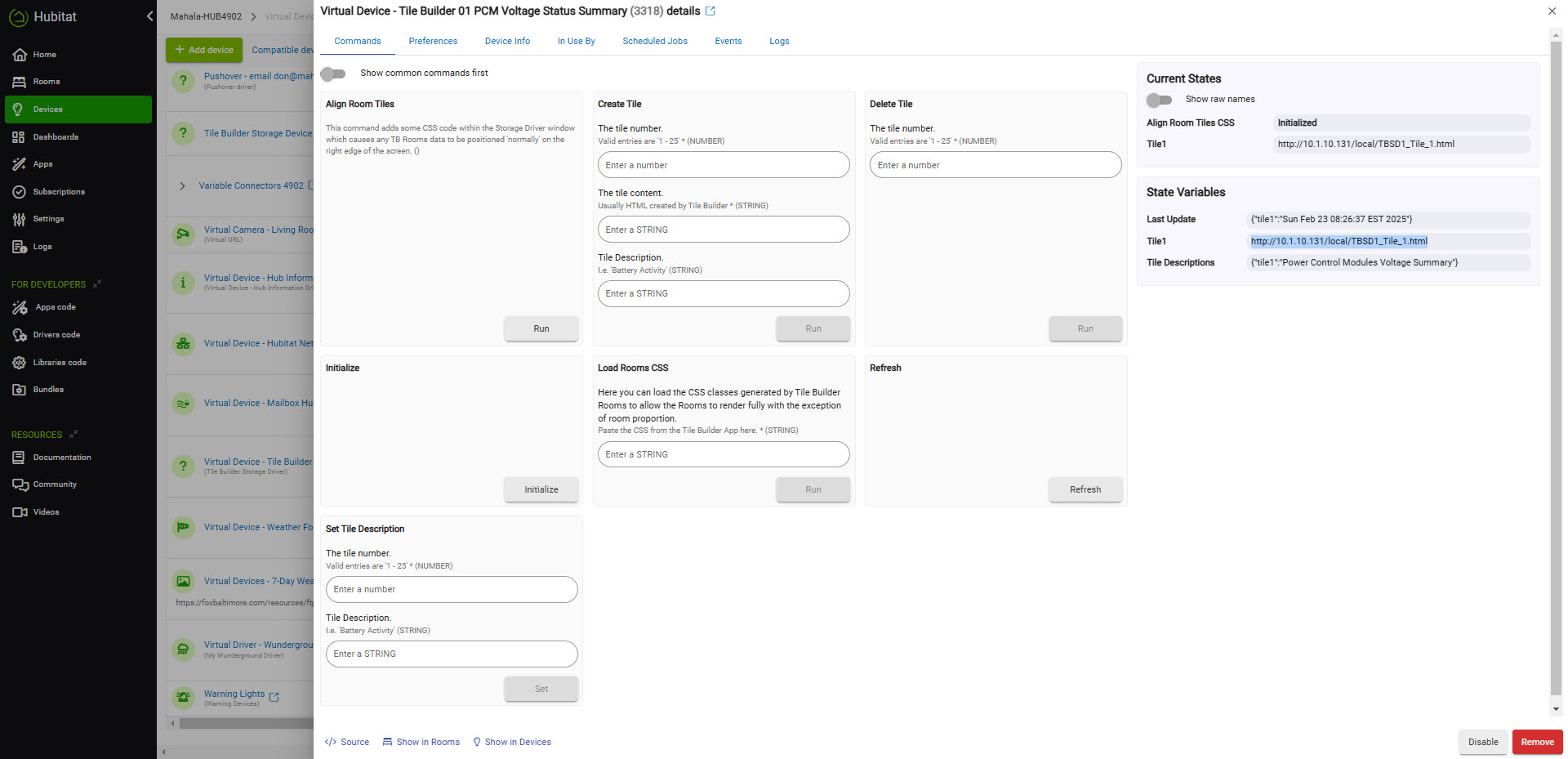

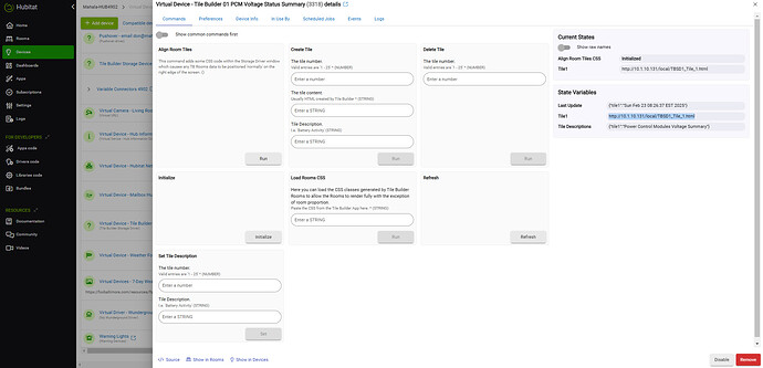

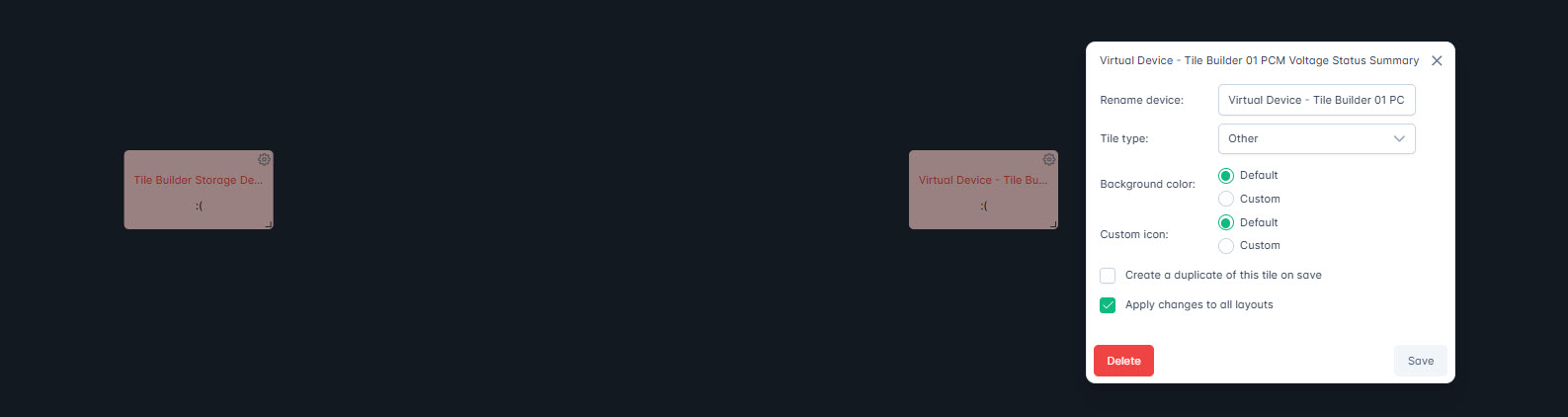

I thought I would try and create a virtual device using the Tile Builder Storage Device Driver as the basis for the device.
I really thought I was on to something. The prompts seemed as though it was expecting just a few data points from the previous setup of a tile and virtual devices are a somewhat common way to add tiles to dashboards. Once again when the virtual device was added...same old sad icon...ugh :frowning:
The URL from the entry placed in the file manger from the tile creation does resolve. So not sure what part I am missing to get it on the EZ Dashboard. Seems like I am close. I just can't get it across the finish line :slight_smi
Lastly, I don't believe setting up a virtual device just using the URL as I have done here will work since it looks like it will not pick up column formatting and maybe other "stuff" being managed by Tile Builder.

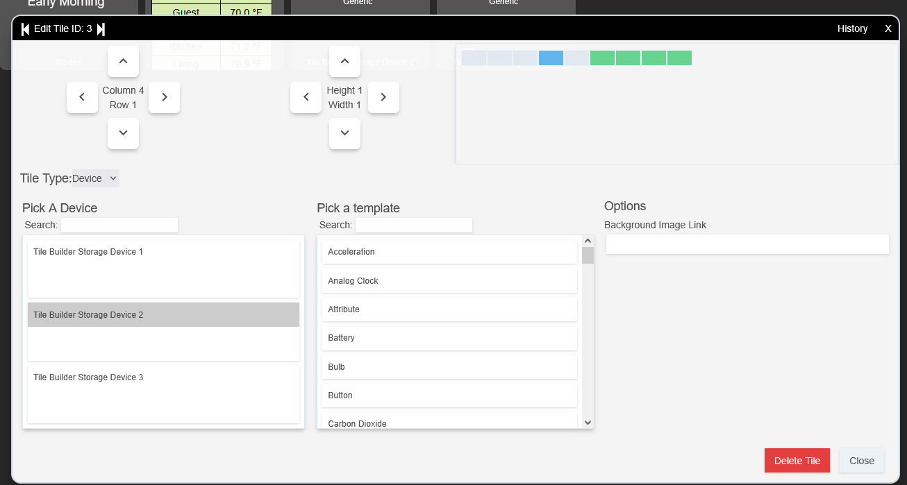

Wow - I had never opened EZ dashboard - and you're right - its ... um. beyond me. I think the EZ dashboard is supposed to be really simple.
I did pop the old dashboard on for a minute - and it was simple there.
Make a regular dashboard (legacy it seems to be called now) and add the tile builder storage.
then open that dashboard and take the defaults to get started.

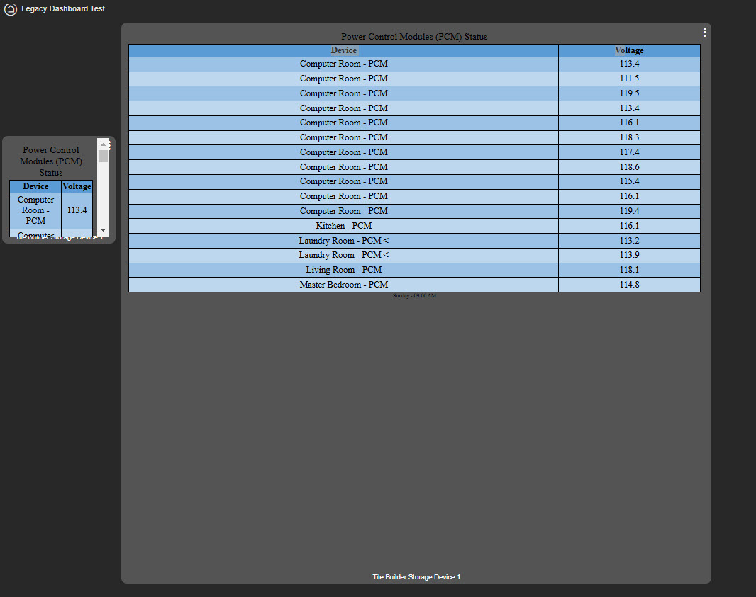

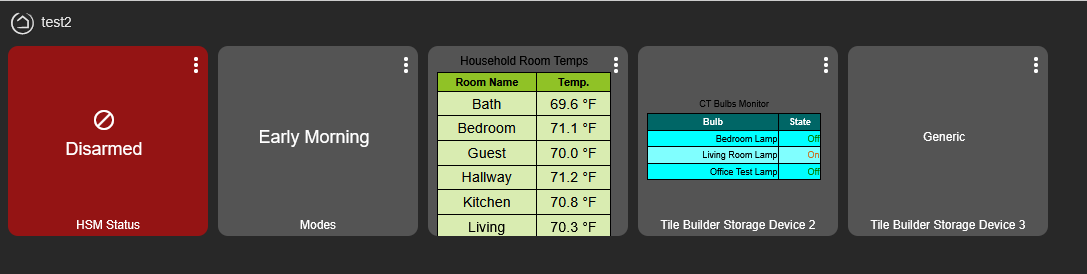

Here is my tester - I have 3 tilebuilder storages 1,2 and 3 so...

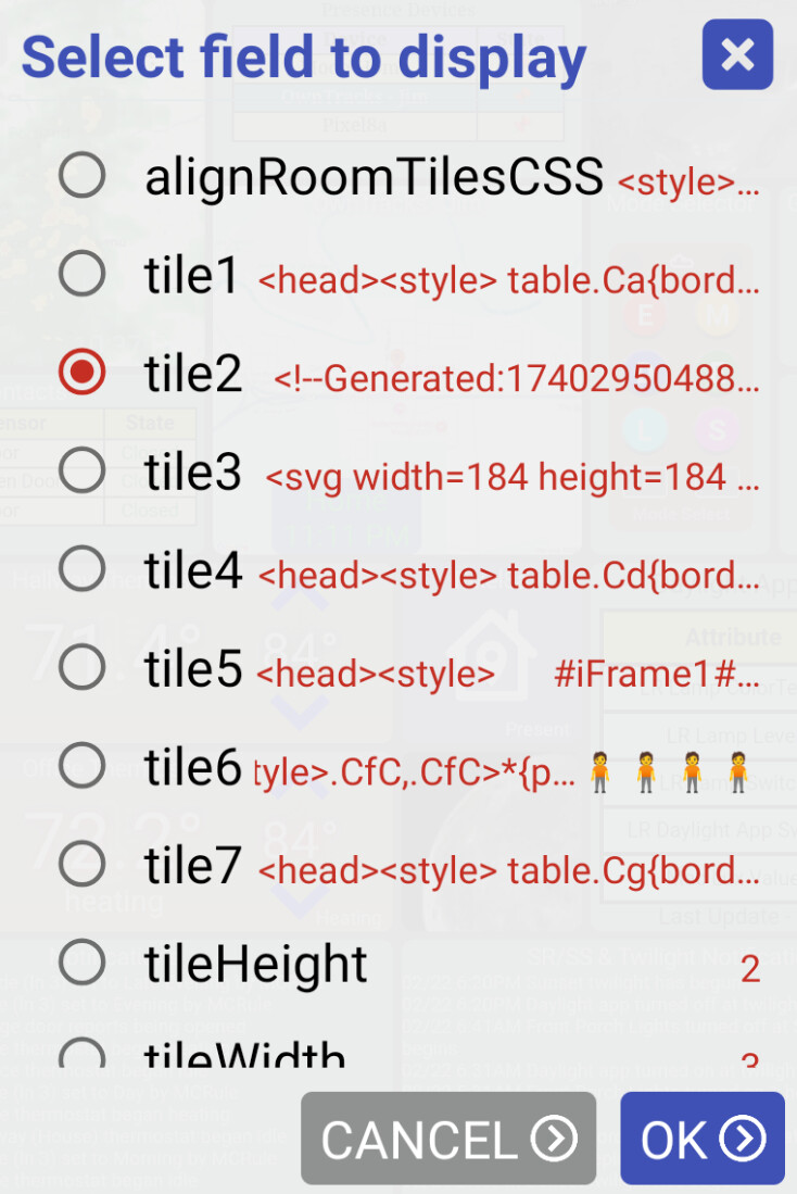

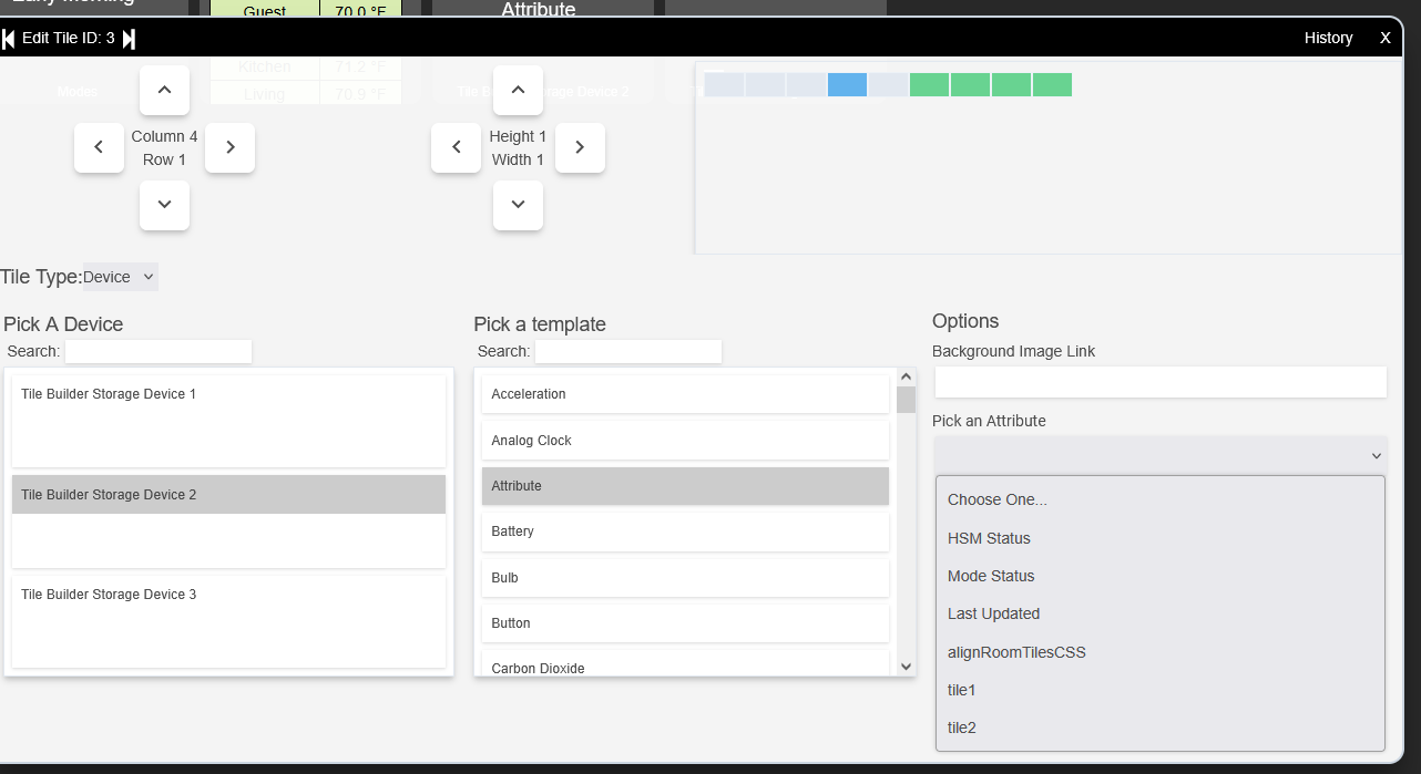

Next, click the 3 dots in the top right corner of the tile and open it. You'll get a tile config screen similar to this:
Choose 'ATTRIBUTE' in the center drop down, then in options choose the tile # within the storage container that is holding your desired tile:
save and review.

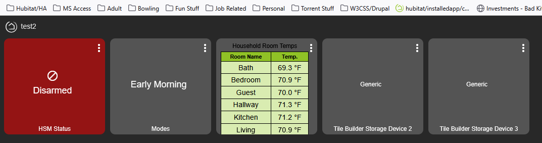

Here's the result from me picking an 'attribute' for each of the first 2:

You nailed it. Working in Hubitat Legacy Dashboard but not in EZ Dashboard. I am going to see if there is something I am doing wrong in Tile Builder but I will not roll back to Hubitat Legacy dashboard. Does anyone else know if Tile Builder is compatible with EZ Dashboards?

Sorry I’m late to this thread, I’m out of town until the end of March. EZ Dashboard does not support an attribute tile to the best of my knowledge. EZ Dashboard is quite a bit newer but I’m hoping they will add that capability in the near future as it is quite widely used.
