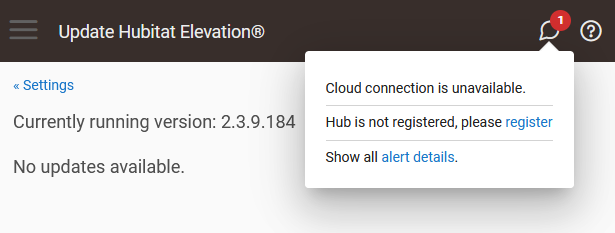

Cannot download hub updates
Hardware version: C-7
Platform version: 2.3.9.184

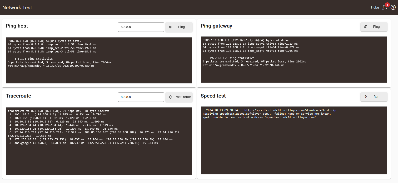

I also setup 1.1.1.1 as the only DNS server:
Using Network Test, I got the following results. Speed Test failed, but seems like the hub can reach the Internet:
When I check for updates, I get the following results:
{4905040A-2439-4B54-8ACD-9858A0EE4F51}
Edit: I rebooted and even shutdown the hub, same results.
I am able to install and update packages using HPM, so I guess hub has no problem connecting to github.

Hub needs to be registered and connected to the cloud server to receive updates (really the only time it needs the internet).

My understanding is that the hub doesn't need registration to update. It may have problems connecting to cloud though.
If you explicitly disabled the cloud controller, then yes, you'd need to enable. Registration is not required, but cloud services are, as downloading the update is done over cloud.
