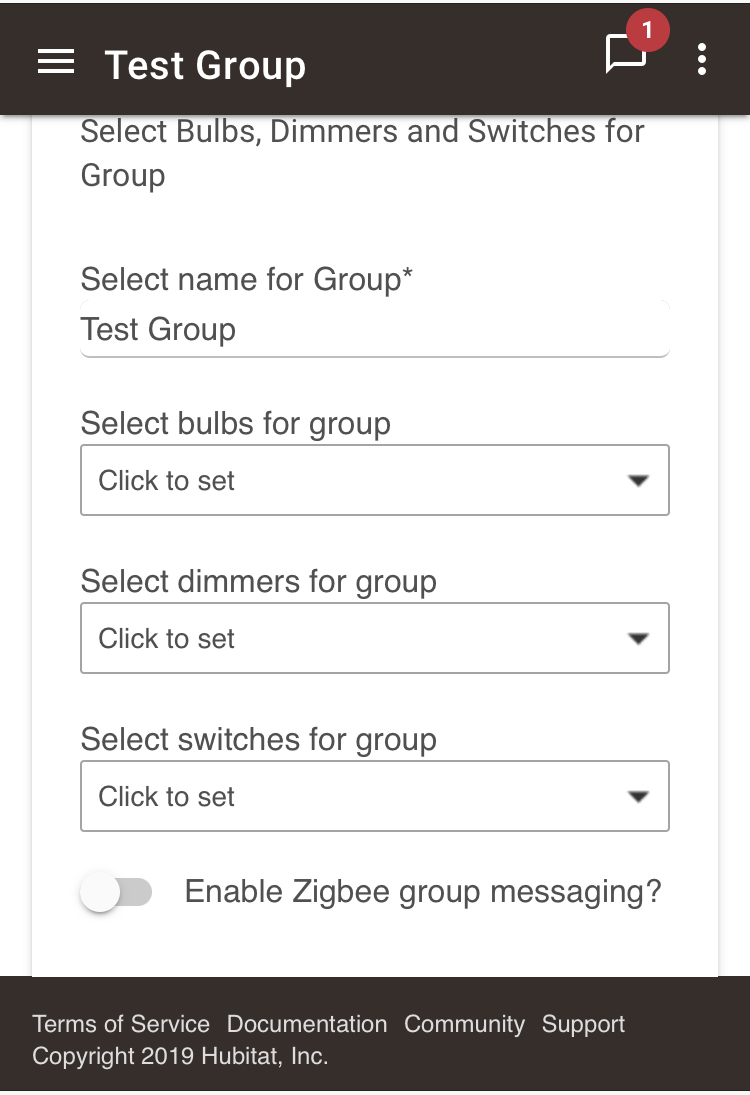

The Hubitat Groups and Scenes App allows the selection of "Bulbs", "Dimmers", and "Switches" as shown below.

Ok, in that case they are "smart dimmers". When i click onthe dimmers group in your photo above they are listed there and i select them. But when i hit done, nothing happens, no group is created, its almost like the "done" button does not work.
