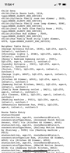

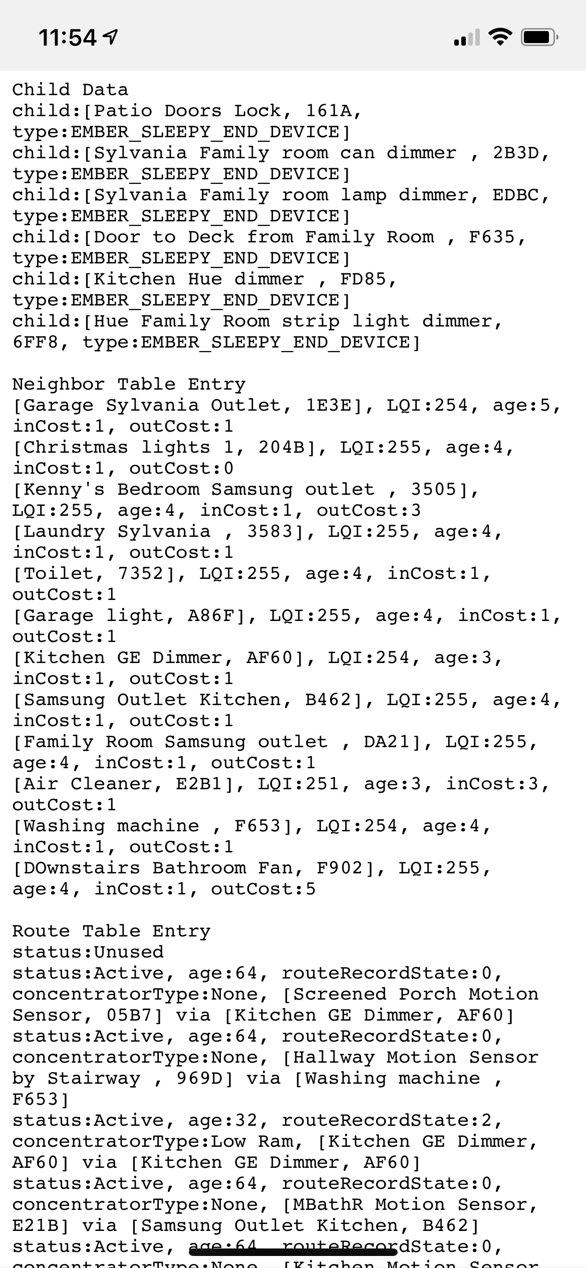

Did you try hitting “configure” on the device page? It should be automatic when pairing the device, but perhaps something went wrong. Also, I have found that it doesn’t really matter that the lock is close to the hub. It is still very likely that it is not directly paired. You can check http://hubIPaddress/hub/zigbee/getChildAndRouteInfo
It will be listed as a child device if it’s directly connected.
You can see that one of my kwikset locks is a child device, which happened when I had the breaker off while remodeling the master bathroom, which took down a couple repeaters for several hours.
