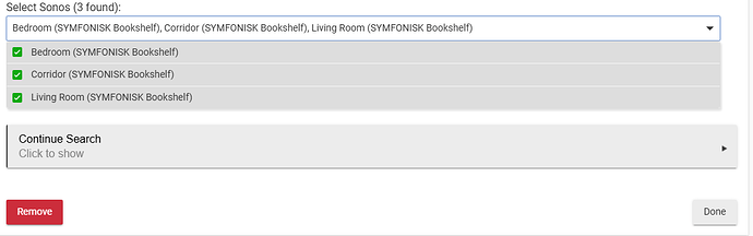

Long time ago I added successfully two Symfonisk Speakers. Now I am trying to add a third one but no matter what I am/was trying I cannot add it. I am/was using a built-in Sonos Integration app. The app can see all 3 speakers (trying to add a Corridor one):

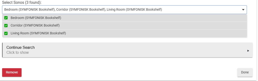

All 3 speakers are selected:

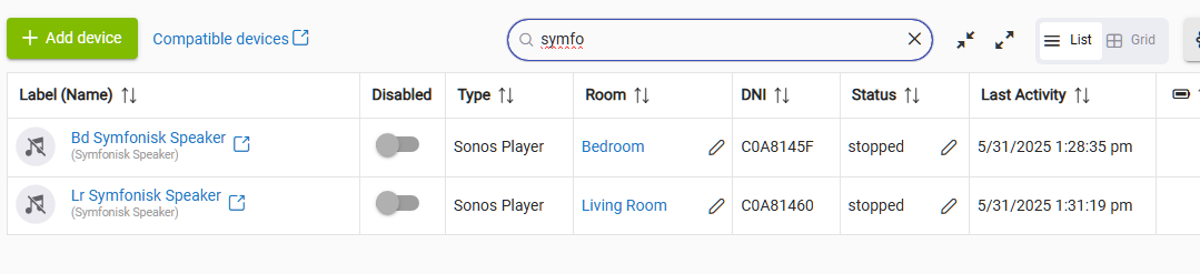

Of course, I clicked on Done button. It looked like app was doing something but Corridor Speaker was not added, only two existing speakers are listed:
Rebooting a hub did not help.
What I am missing?
UPDATE.
OK, app was removed and reinstalled.
After that third speaker was successfully added and it works.
This makes very little sense but it is what it is ...

Original two speakers were installed back in 2021 on the C5 hub (migrated first to C7 followed by C8 and finally to C8 pro). Until today I did not touch anything in this area.
