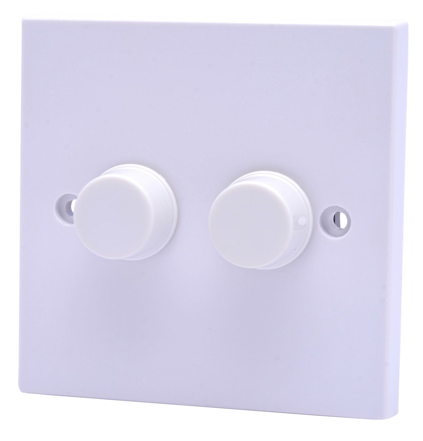

Also, I have two of the Candeo C202N dimmers and am looking for a face plate that is wide enough to house them. The double dimmer supplied by Candeo themselves C102 is not wide enough (only by about 2mm) thus you cannot simply replace the dimmer modules sadly.
I have found one of them to drop off since so changed it to the generic zigbee dimmer. I contacted support a few weeks back but they haven’t replied. I found cutting the power completely jolts them back into life and then they report live dimming. One is your device setting and the other is the original to test which one works best for me. I got this plate from a website but can’t find it now, if I do I will post.

After I ordered several single socket dual dimmers to find one that could support two C202N modules side by side I found one. It is the "Power Pro Double Dimmer Switch 1 Way Turn On/Off."
I beleive it is also sold by B&Q in the UK although this is a 2 way so it isn't quite the same model but more importantly, the face plate looks the same i.e., the rotary buttons are spaced further apart than most others:
