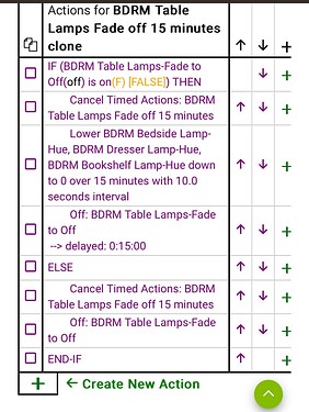

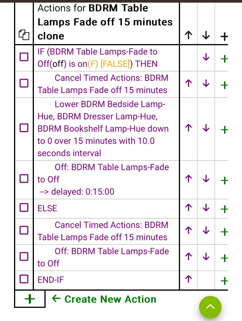

The following rule fades some lights to off over a 15 minute period. Sometimes I need to cancel the lowering/fading of the lights midway through. I thought that calling cancel timed actions (from another rule) would do the trick, but it doesn’t stop the lights from fading to off.
How do I stop the lights from fading/lowering?

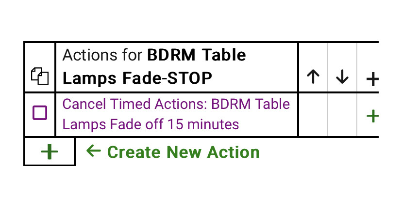

Just realized I referenced the wrong rule with Cancel Time Actions!
Cancel Timed Actions does in fact cancel Fade over time.

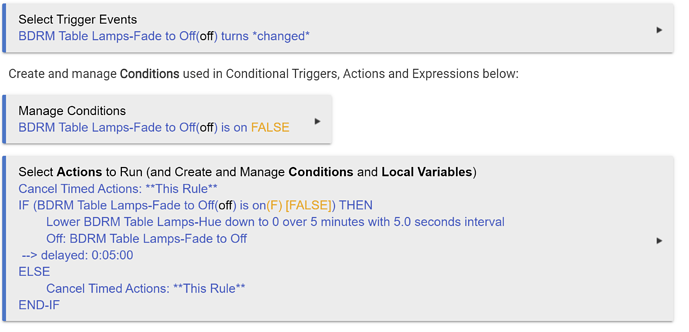

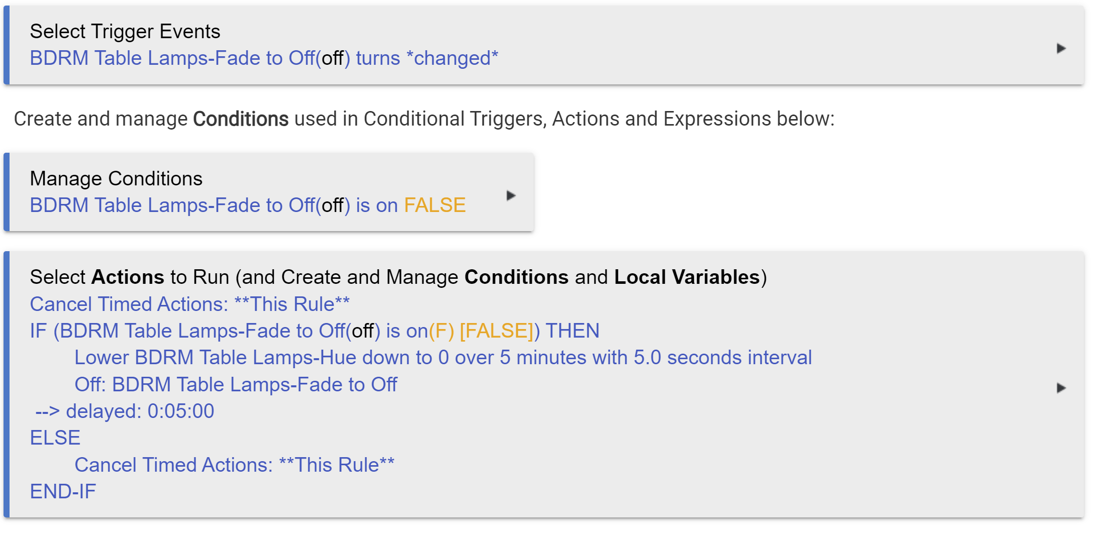

I think I have it working using this one rule:
I had to delete the first action: Cancel Timed Actions: *This Rule
Now it's working correctly.
Glad it's working for you. Only thing to watch out for is using change as the trigger. It is possible to get the virtual switch out of sync. With that said, if it does not matter to you, then the rule should work.
