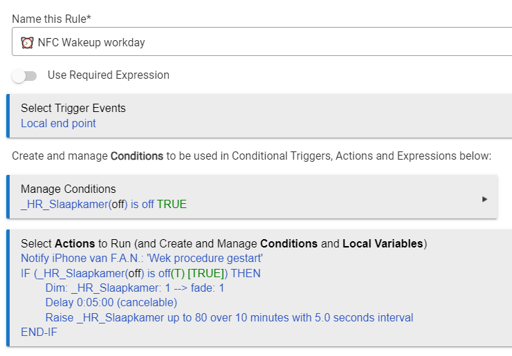

Question for the RuleMachine wizards in here:
I have a rule that switches on the bedroom lights to 1%, waits five minutes, and then raises the dimmer level of the bedroom to 80% over 10 minutes. The rule is started by triggering a local endpoint (NFC tag).
We have two switches in the bedroom, one by the door, and one by the bedside.
I want to stop the running "raising lights" rule when any of the buttons are presssed.
Seeing I could not find a way to do this in the rule itself, I thought about setting up a new rule that basicly stops proccessing another rule if any of the buttons are pressed.
Yet the only thing I can find is that I can pause a rule, but not cancel it.
How would I stop processing a running command in a rule?
The "wakup" rule itself:
