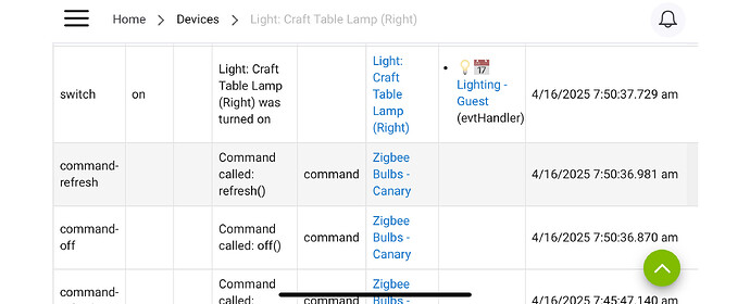

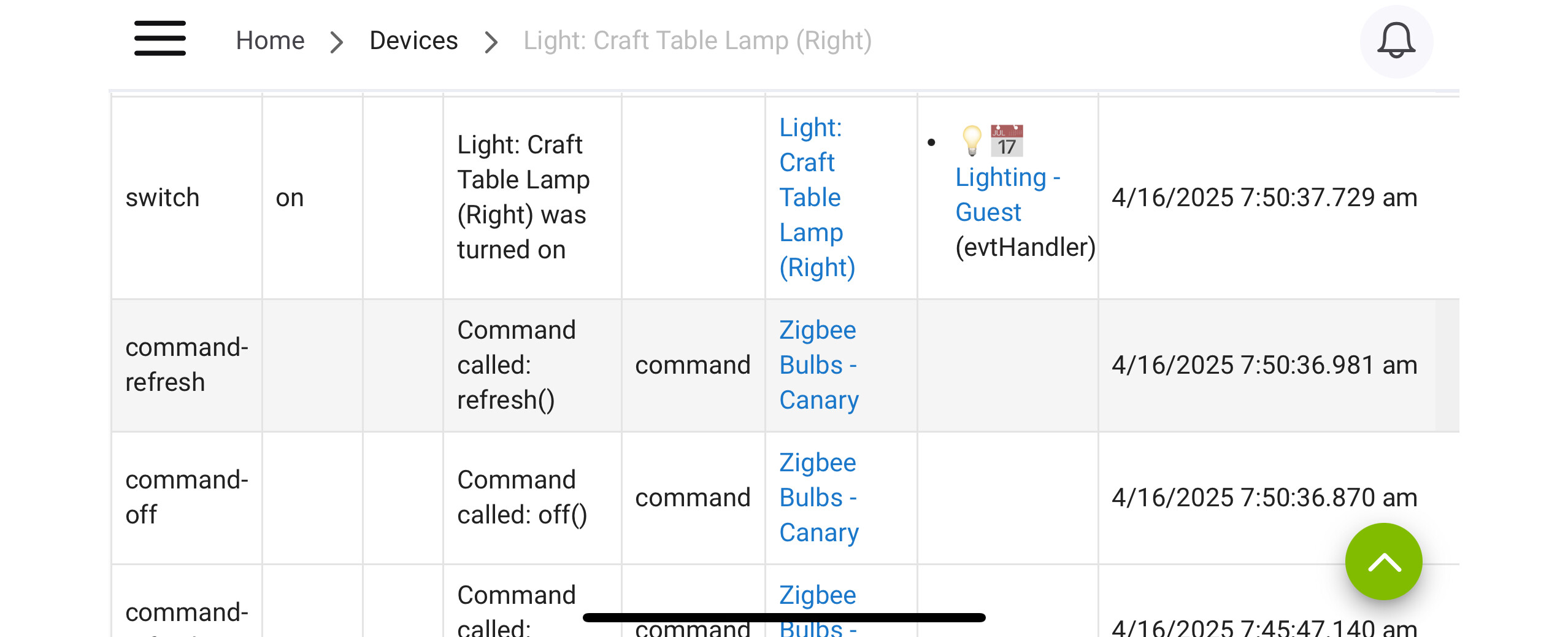

Does anyone else here use the Canary Bulb app?
It works great for the most part, but I noticed that not all of my Zigbee bulbs would turn off because there is a delay of when some of my bulbs turn back on after an outage. Sometimes, they turn back on AFTER the Canary App issues the “off” command. I think this is because the Canary Bulb might be coming on before those other bulbs. The difference is literally like 1-2 seconds. Here’s an example. Canary Bulb App issues the “off” at 7:50:36.870 but the bulb doesn’t actually turn back on after the outage until 7:50:37.729
Can someone more tech savvy than I am please take a look at this app and tell me where to add a delay please? Like, even just a 5 second delay before issuing the “off” command would work.
