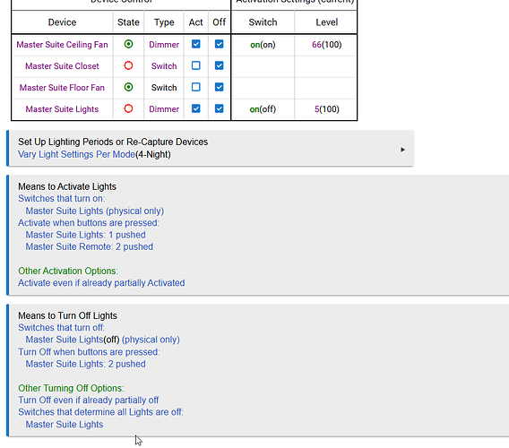

Personally I solve this issue with room lighting. I can set the preferred levels per mode (or time groups). Then I have the switch turning on, activate the RL app which then sets it to the proper dim level. I avoid the bright flash by setting the default level on the device to a lower level (a setting on Zooz dimmers), and then the RL will ramp it up to the proper spot based on the mode.
No virtual dimmer involved with this method, so setting a specific level is not a problem once the light is on.
Here is my most basic example (sorry all of mine are sort of complicated).
This one can also be activated via a remote, and it also is setup to turn the fan on at night, but not back off again until morning (in the period setup).
In the "Set up Lighting Periods" is where you set a different level per mode.
