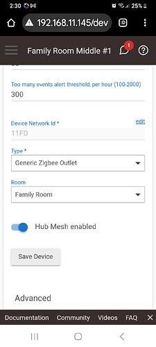

Ok, @aaiyar , every one of my zigbee mains powered plugs that i have paired to hubitat zigbee it shows this:
Even my battery operated devices have that switch in hubitat but I did not select it for any battery operated devices.
Am I doing this incorrectly?

Do you have more than one hub? If not, that option is not doing anything. It is there if you do have another hub, you can share devices between them using hub mesh.
So, you saying that has nothing to do with the zigbee protocal communications?

Correct. Hub Mesh is for communication between hubs.
Fire up the other hub. From the first hub, select a device and enable Hub Mesh. Go to the other hub, select Settings, Hub Mesh, then Linked devices. You should see the device (and maybe others, if you have other devices with that option enabled). Click on the + and it will now be visible on this hub, available for automations.
One reason for this is like in my situation, I have 3 buildings that are not in z-range. (Yes, even ZWave-LR). They are connected via ethernet, so I have a hub in each building connected via Hub mesh. I also have a main hub that has the rules and non z-devices (Lutron, web based, etc.) All are meshed.
Ok, so it is hubitat hub mesh only. I think I got it.
