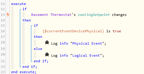

You can do it in Webcore by checking the $currentEventDevicePhysical flag.

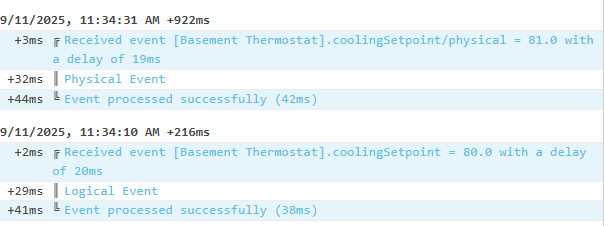

Yes, I tested that piston I posted with my T6 Pro thermostat before I posted it. I changed coolingSetpoint on the driver page (got a Logical Event), and then with the Thermostat controls (got a Physical Event)
testPhysical
