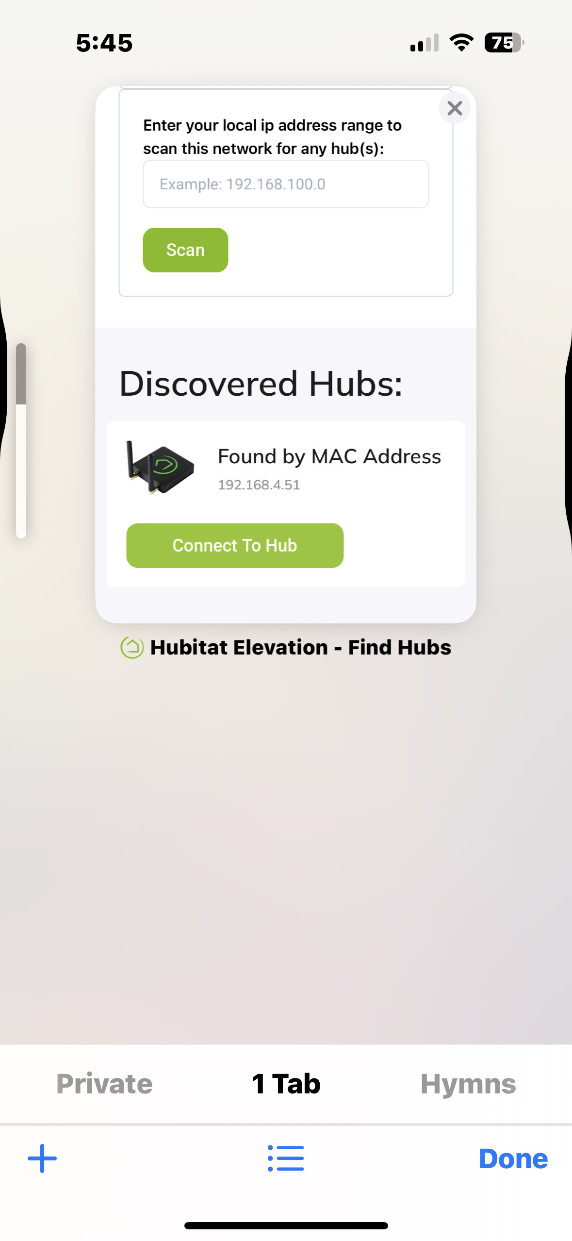

I can’t get into the Hubitat to do anything. I’ve unplugged, I’ve used the button on the bottom. It shows up on my eero. It even shows up in findhubitat using the MAC address. I’m just not able to connect with it via the browser.

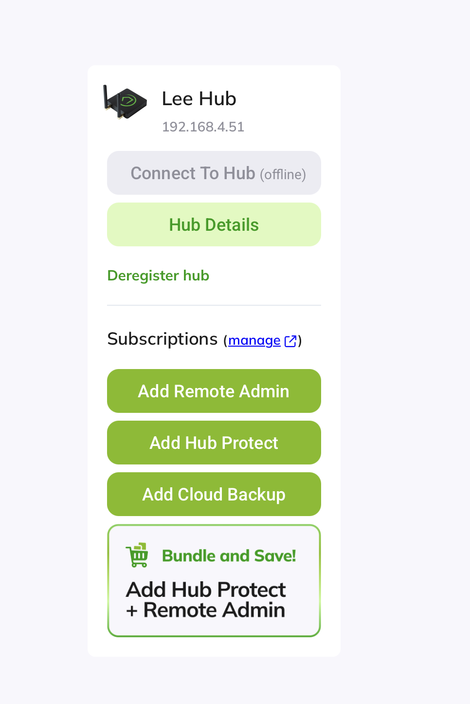

My Hubitat and Eero router are on the same subnet. I've tried connecting the "My Account-Registered Hubs" using my Mac - Safari browser. Im attaching a screen capture of that.

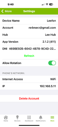

Also, unless I am looking at thing incorrectly, your 2nd screenshot shows your phone with an IP of 192.168.5.11. Your last screenshot shows your hub at 192.168.4.51. Are you sure those are both on the same subnet/VLAN?

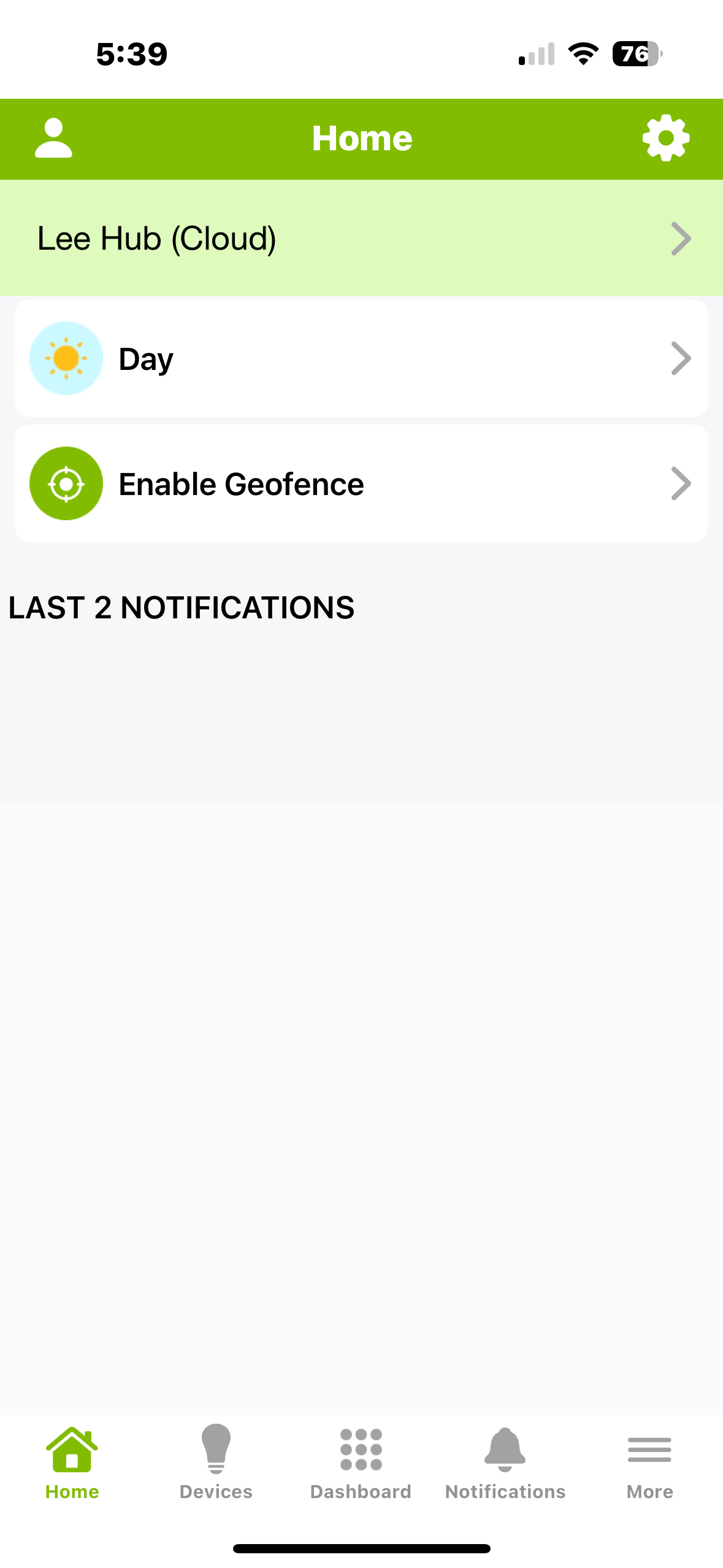

It's still working fine, or at least your hub is connected to our cloud. You'll need to figure out why your devices are not seeing the hub on the same network.

So I second the suggestion to confirm the IP addresses of the hub, and any devices that are used to attempt to browse to the hub’s UI (mobile phone and Mac).
