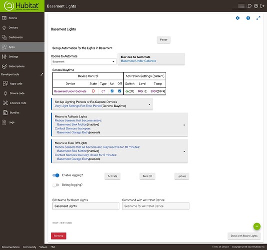

here's my new attempt at a rule from scratch. let's see how it goes!
That should work how you expect it too, though you don't show the triggers or ways to turn off the lights. But during the day it'll be 100% and white, in the evening 100% and red, and at night 13% and red.

So I’ve simplified my rules to be “when motion, turn on, leave on for 10min since last activation event”
With that simplification I’ve determined my confusion stems from the light not activating property if I spec a Color Temperature (I thought the problem was time periods when it’s actually the CT call itself that’s not working, thus I don’t see my light coming on). I’m only using CT mode during my daytime (trying to get 3000k). Both my later periods use RGB mode to set pure red with two levels of brightness. The CT completely fails, the reds both work flawlessly.
If I go over to my device and manually set a CT it works fine. So what’s different about how the lighting app initiates a CT call compared to issuing it from the individual devices tab?
