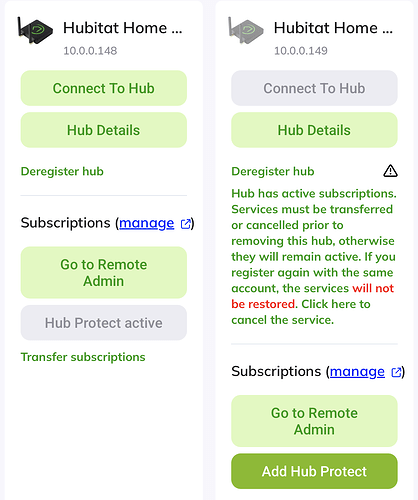

I'm also having this problem. My old C-8 can't be reset, can't be deregistered. The only message is that subscriptions are active. It appears that Hub Protect fully transferred to my new C-8, but remote access is still active on both.
(Note: this was the reason I tried to do the transfer twice and hosed it up.)
I can assure you that everything worked as expected. The Remote Admin didn't stay active, was immediately activated after transfer on the old hub that was now "missing" the Remote Admin access :flushed:
The fact that hubs having Remote Admin acces but not an active subscription are unable to be reset using the Full Reset, is an inconvenience that will be addressed.
Meanwhile, you should be able to de-register the hub from my.hubitat.com, then run a Soft Reset without restoring a backup and reset the radios from Z-Wave/Zigbee details pages (same thing that a Full Reset would do, but in a sequence of automated steps).
I am not able to deregister. New on left, old on right. Should I run the other steps anyway? Or wait for the inconvenience to be addressed? I'm not really in a hurry on this one.
I de-registered your hub from our end. You may continue with the other steps. Just don't click to register the hub again.
