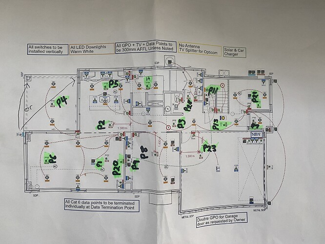

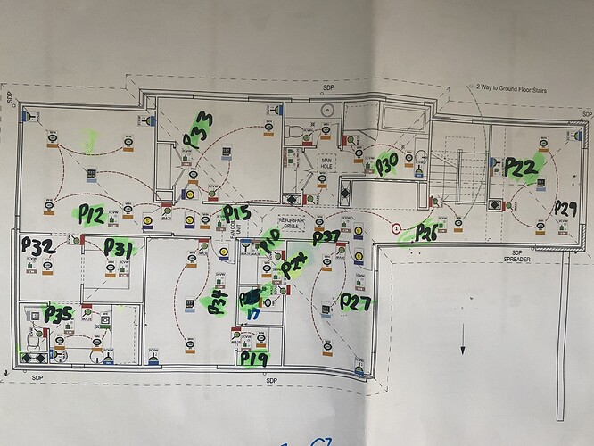

Below are house layout of first and second floor with aeotec multi sensors powered by POE labeled as “P..” The Hubitat hub is located under the stairs on ground floor
So steel studs in all the walls?
Also, anything in the garage, there is possibly extra material in those walls for a fire rating. Possibly just extra thick sheeting. Could be something in that causing more interference.
The Garage Switch device looks like it is more chatty than others, lots of route changes as well. That device is possibly flooding the mesh with discovery trying to re-route all the time. It also has S0 security. Is it to control the garage door or some other switch?
