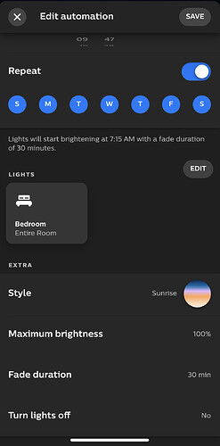

I have this in my Philips hue app, but mostly I sometimes want to adjust the time I want to wake up.
Can I manage this sort of thing within hubitat and therefore schedule a different time, disable if I’m not sleeping at home, etc.
Does this have to be Alexa? I don’t have it really want anything Alexa. But I don’t think my Google hike has access to the hue scenes?
