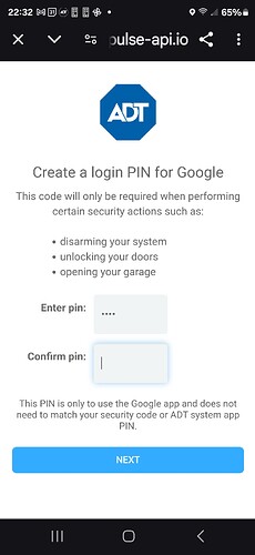

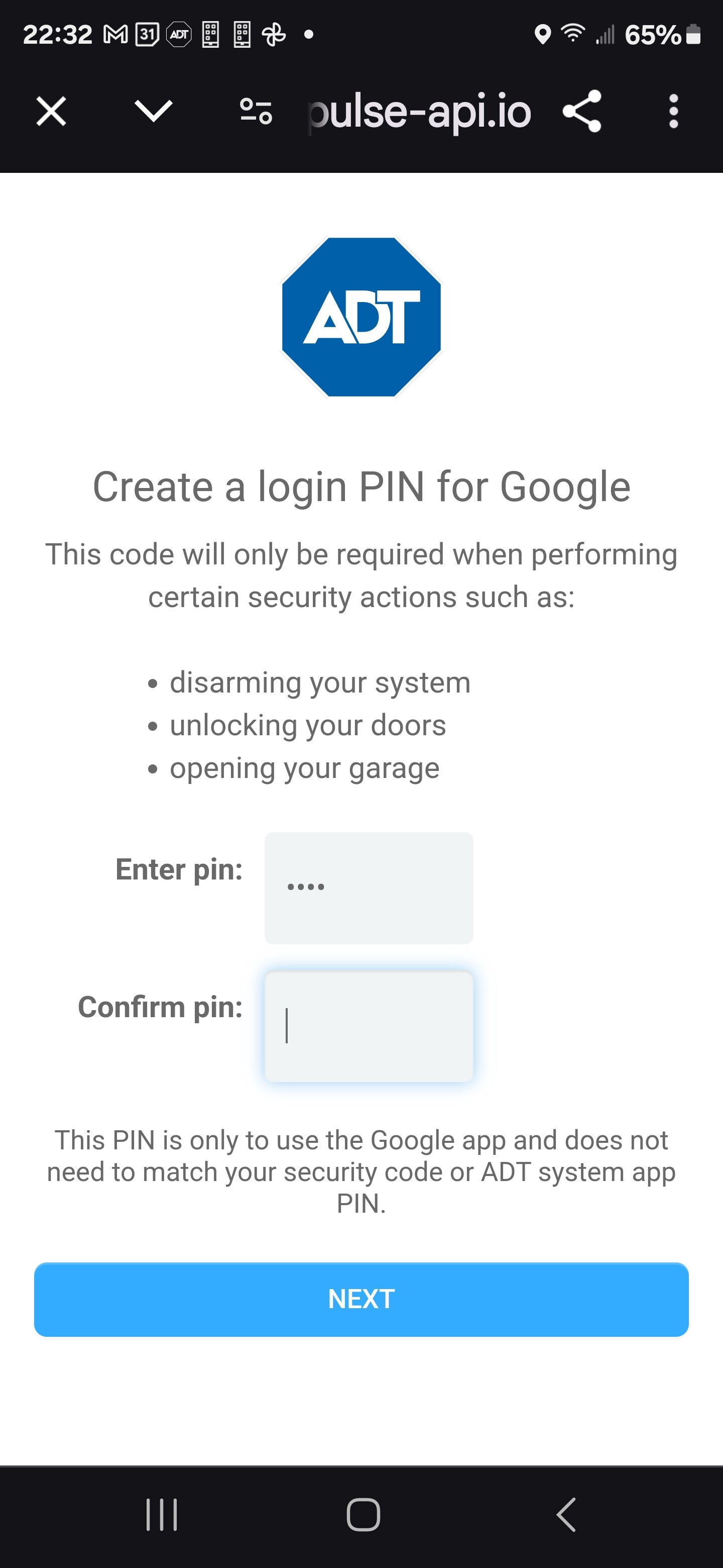

Confirmed suspicions about the integrations. I moved my locks back to the ADT controller, and when I refreshed that connection to Google Home, ADT prompted me to create a PIN for use in lock/unlock and arm/disarm through Google Home. I forgot about doing this when first setting up those locks last year.
