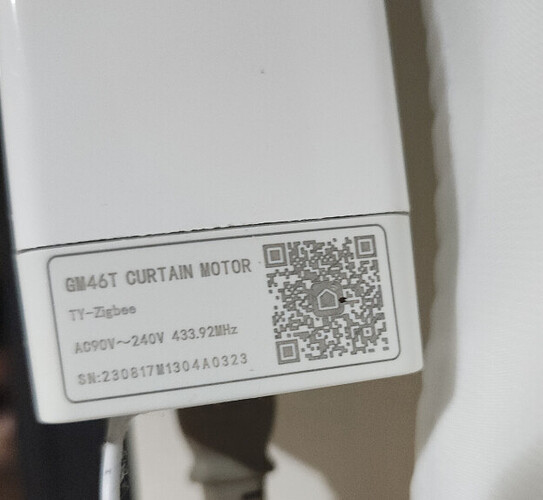

This is the device btw
GM46T CURTAIN MOTOR
TY-Zigbee
AC90V~240V 433.92MHz

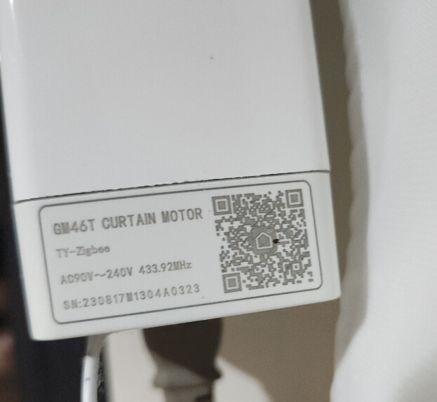

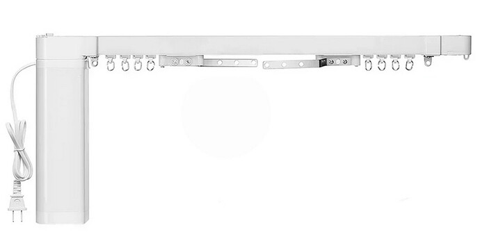

my curtain motor is
Sold to me under WC-PJ220 (Moes brand) curtain motor
but the sticker on the motor itself shows
GM46T CURTAIN MOTOR
TY-Zigbee
