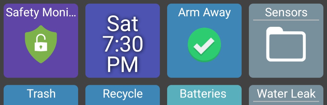

When building a dashboard for our mobile phones I built an area with a notification section with critical items. I wanted to add switches there for HSM home and away. When looking inside HSM for the arm/disarm direct link options there is an option to cancel alerts with switches but not to arm (any state) or disarm that I could see. You can do it with button devices but it would really be nice for switches.
Am I missing this or does it not exist. Switches would be good because of leaving them in the "on" state on the dashboard for color recognition. I was not able to do this with buttons.

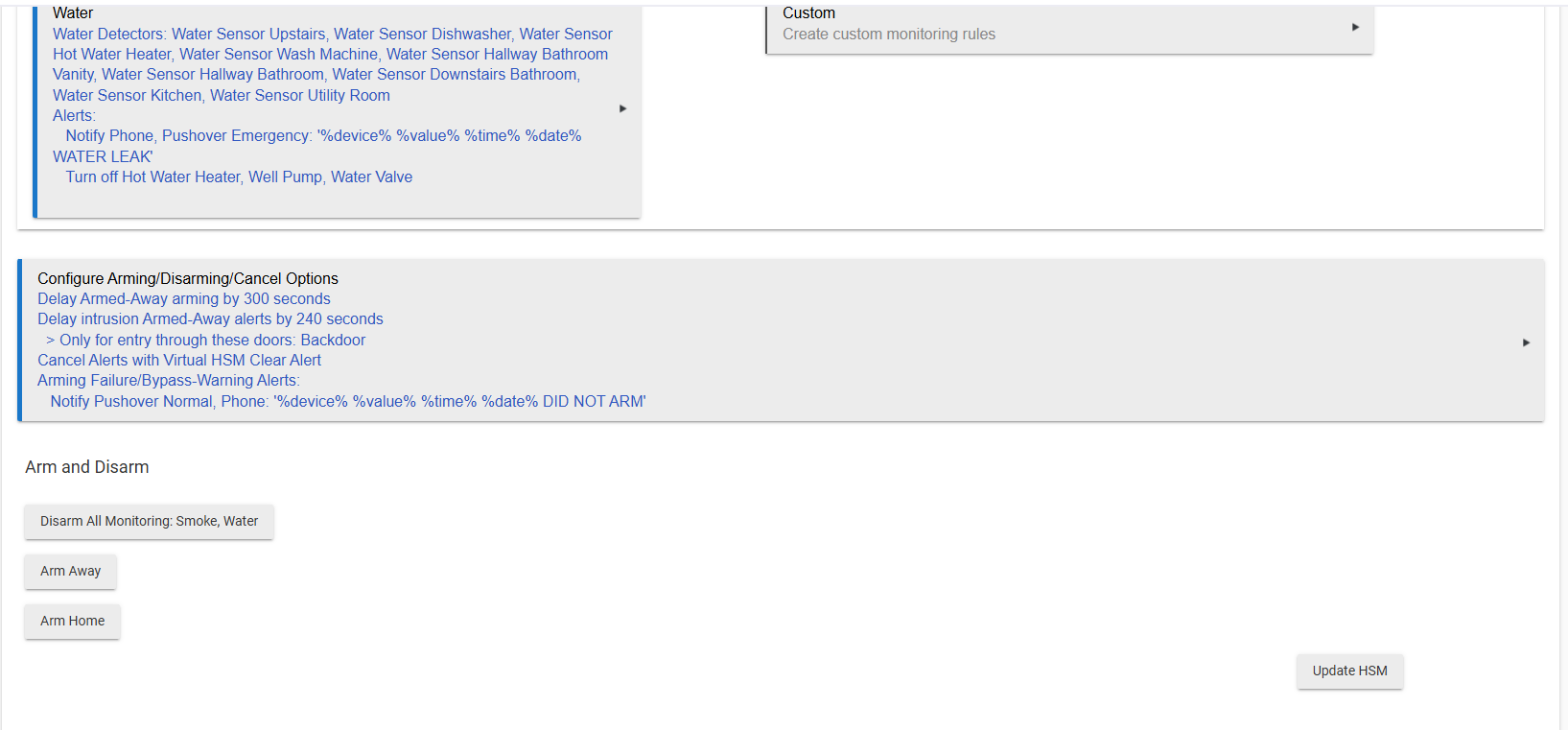

Look at the confiquire arming/disarming at the bottom. Here I have a virtual switch to do it
Sorry, did not read your post close enough. Don't see a way.
Thank you for looking at it. I created virtual switches as well for Arm Home and Arm Away. Then I wrote 5 separate rules in rule machine to arm HSM when the switches are on, turn one off of the other is on, disarm the system if both are off, and to turn the home or away switch on if HSM is triggered through the HE app or the UI. It seems to be working reliably with no issue, it just is cumbersome. I thought there might have been a simpler way.
Seems like maybe a virtual switch button would work.
