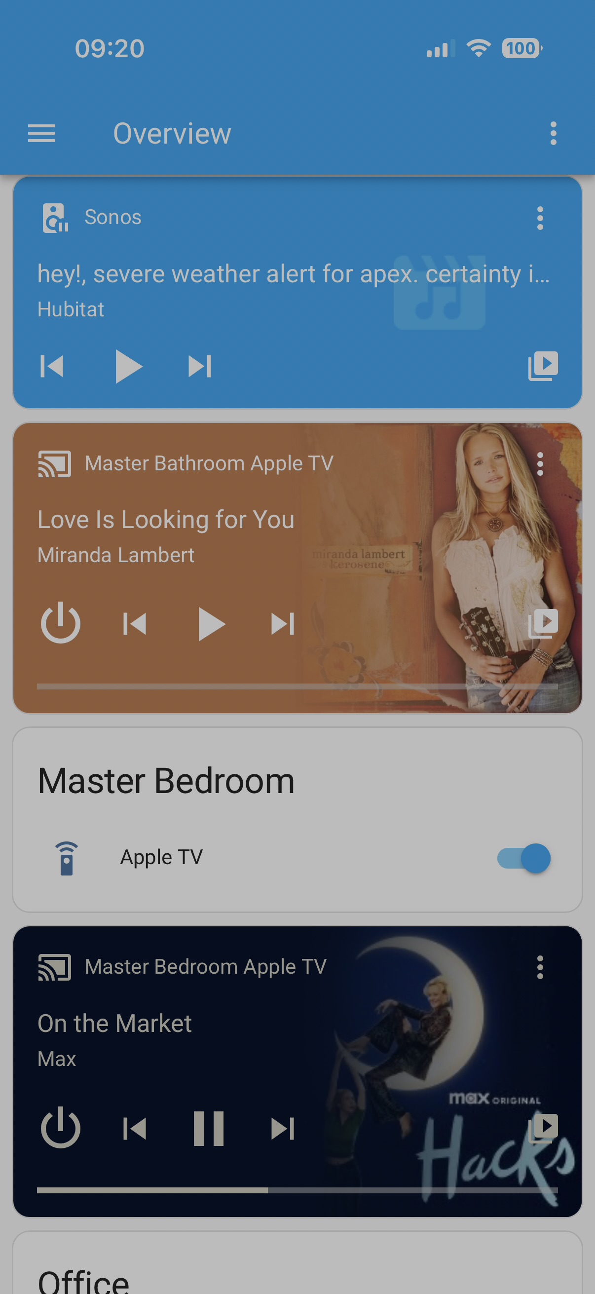

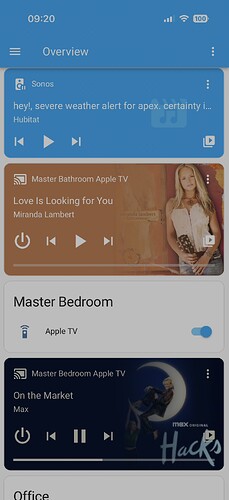

You can have some control of ATVs with Home Assistant, so maybe there’s hope for future development.
Digging through their source code, they appear to be using a package called pyatv for this. From the pyatv documentation:
As pyatv depends solely on private and reverse engineered protocols, things sometimes break because Apple changes something. Or because of other reasons. This section covers the major things that you need to be aware of.
And then they list a few oddities, none of which seem like dealbreakers at the moment, but...they did say it could change. So, nothing Hubitat couldn't do, but it does come with lots of strings. For comparison, things on the HomeKit controller side of things are reverse-engineered too, but since HomeKit accessories depend on that having been standardized a certain way (and Apple has that side of things pretty well documented), breaking changes seem less likely there (but, unfortunately, that's not how Apple TV gets itself into the Home app.)
