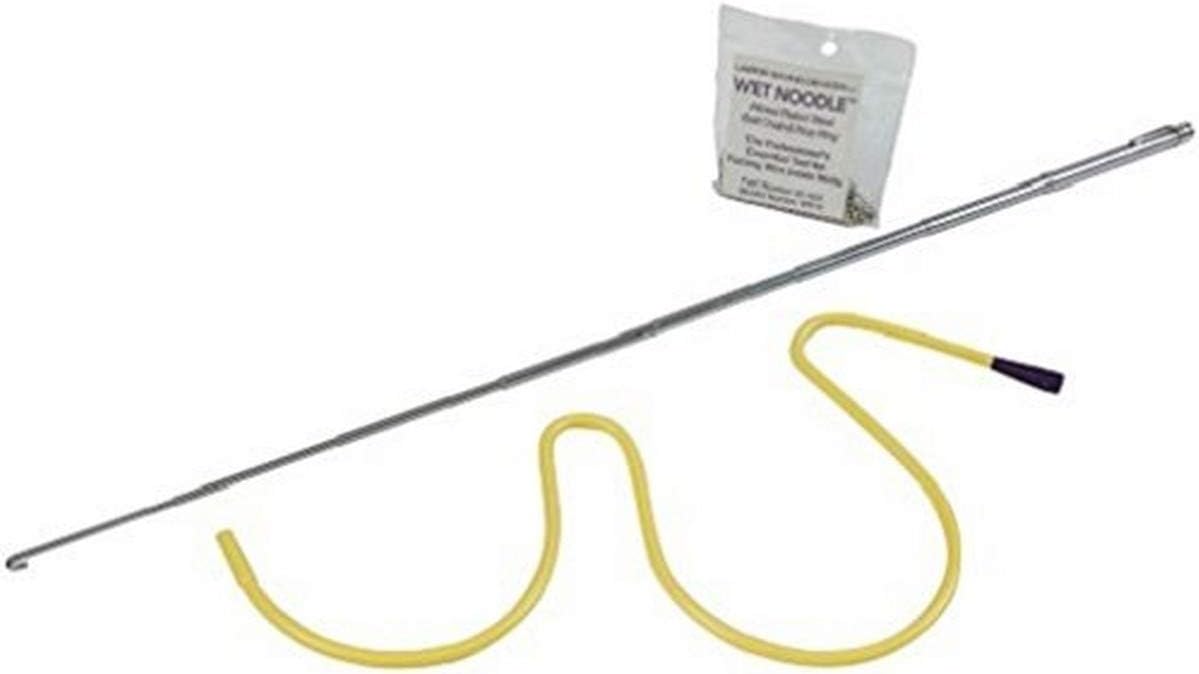

Very true having pulled several 1000 feet but fun comes to an end when you have blocking in the walls... the horizontal 2x4s used when ceilings are 9feet and higher. But if you are dropping wires from above into insulation free stud bays this is the most handy device ever:
