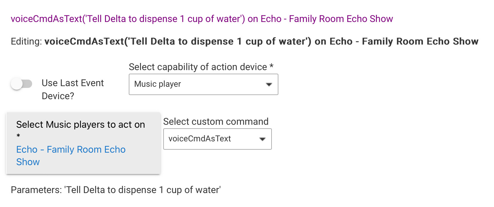

Another option would be to use the “voiceCmdAsText” command where you can just set “tell Dodge to lock my car with PIN 9999” as a command in a RM rule for the Echo device.
Here’s an example I just tested out to get Delta to dispense 1 cup of water. The command will be different, but the principle the same:
Ahh seeing the screenshot allowed me to visualize this approach much better, as it was mentioned earlier by @stephen_nutt. I definitely need to figure this approach out for my other vehicle which requires the pin in a separate command.
