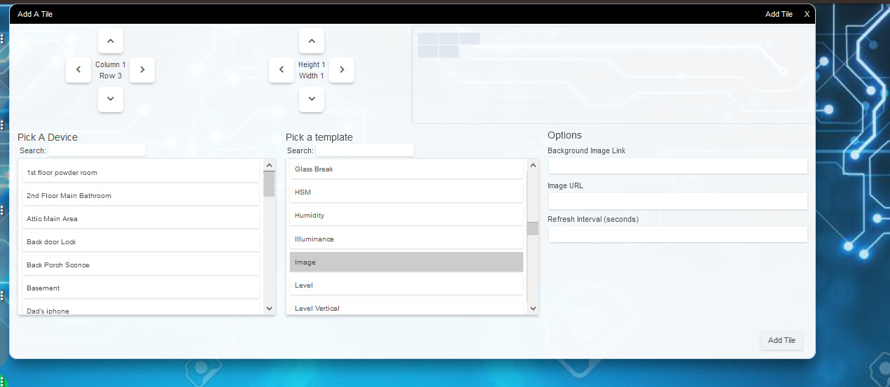

Set up a tile, don't pick a device, under template pick IMAGE, Leave Background Image Link empty, for the image url use the method in your message, and set refresh interval to 1. If that doesnt work, use the jpg only feed portion of your camera stream in the link format under image url
Hi thanks for the quick response.
Ive tried both options with no luck - not sure what it could be. Both the jpeg and mjpeg streams open and stream fine in any browser.
I am using http://user:pass@x.x.x.x:port/image/jpeg.cgi for the Jpeg stream and http://user:pass@x.x.x.x:port/video1.mjpg
