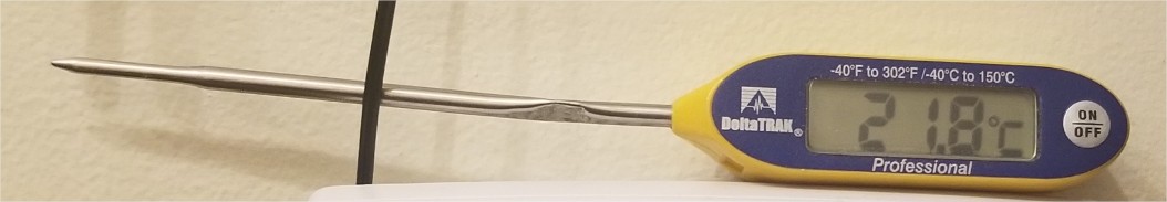

My method is:
With the probe sensor:
Mix crushed ice and water, more water than ice to make an "ice bath". These were used for thermocouple reference junctions in the old days. It will be 0 °C +/- a few 0.01's
Measure the ice bath with the probe mixing slowly as you make this measurement. Note the reading.
Do a similar measurement but with boiling water. This is not as accurate as the ice bath so here you want to be "close" a few degrees one way or the other is enough to determine if the thermometer is way off.
Now for the comparison:
With a small cardboard box 6" cube to 10" cube or similar, put the box on an insulated surface (i.e. putting the box on your granite counter is likely not the best place) where there is no air currents (i.e. from A/C vents, heating vents, etc) allow both to stop changing, probably 10 to 15 minutes. Take readings of both and you have your offset.
This is the best you can do without very expensive ($$$$$) equipment. And it is pretty good, the ice bath is very accurate and in most digital thermometers the error is an offset at all temperatures as opposed to a slope change.
Hope this helps.
