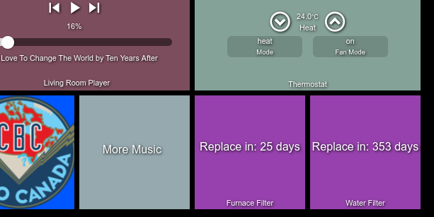

I use them for some tiles on my dashboard that I want to inform me of how many days until certain filters need to be changed. Here are the tiles on my dashboard:
