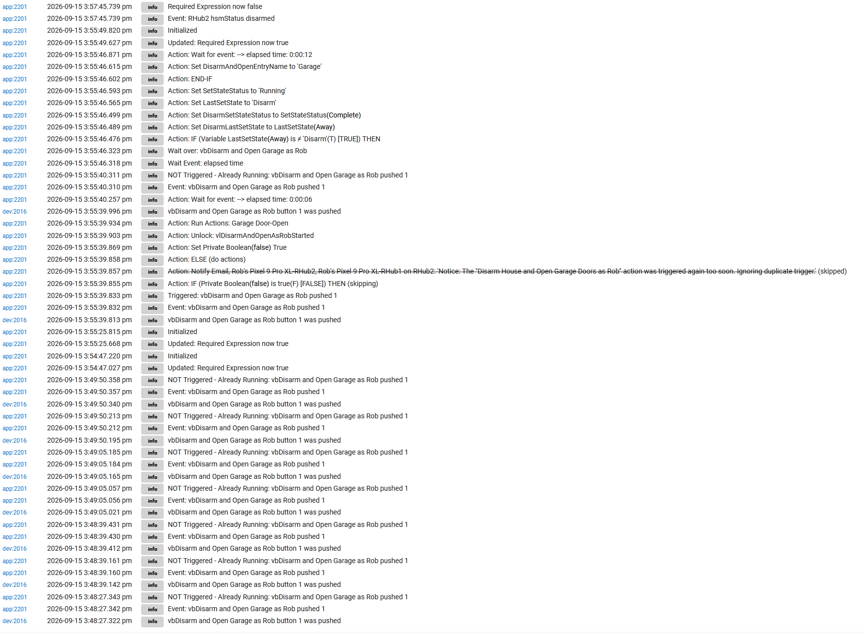

Not sure what happened (and my logs don't go back even a full day, so I can't see what went on before).
In any case, I got a "NOT Triggered - Already Running" message when it should have been triggered.
All I can guess is that the rule THOUGHT it was still running when it wasn't. It must have aborted in error previously. it also left the PB set improperly (
I ended up editing/saving the rule & manually turning off the PB. It then executed fine.
Is there any way to get a longer logging period/larger log?

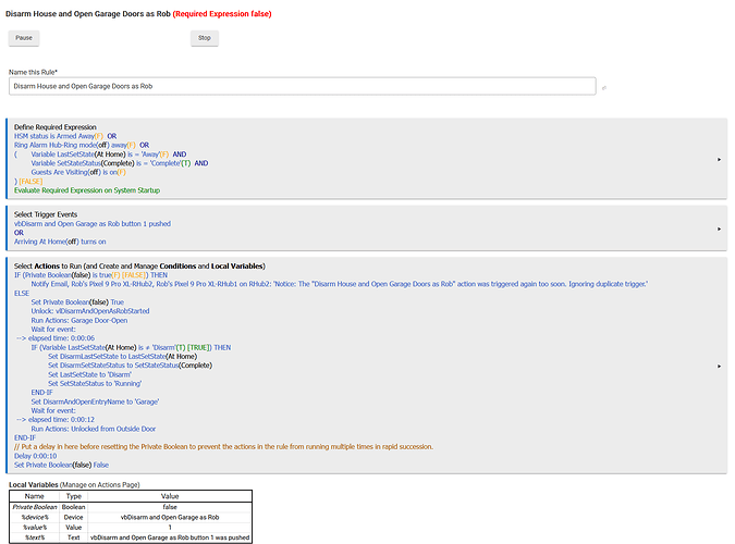

I decided to stop using the PB and go with a time variable.
However, there doesn't seem to be any way to do a time offset in SECONDS--the offset is only in minutes and doesn't allow fractions. Thoughts?

Indeed, the "deprecated" option to prevent the rule from running multiple times WAS enabled.
However, I was only able to see that through when I edited the rule on my mobile (Android) phone. On my desktop/Firefox browser, I don't see that option.
I disabled that now.
It seems that the "already running" code has a tendency to think it's running when it really isn't.
I'm now seeing (with that option off) where the button event is somehow triggering multiple times (no idea what's up with that--I'm using a new, "easy" dashboard to display the button and pressing that on my phone).
