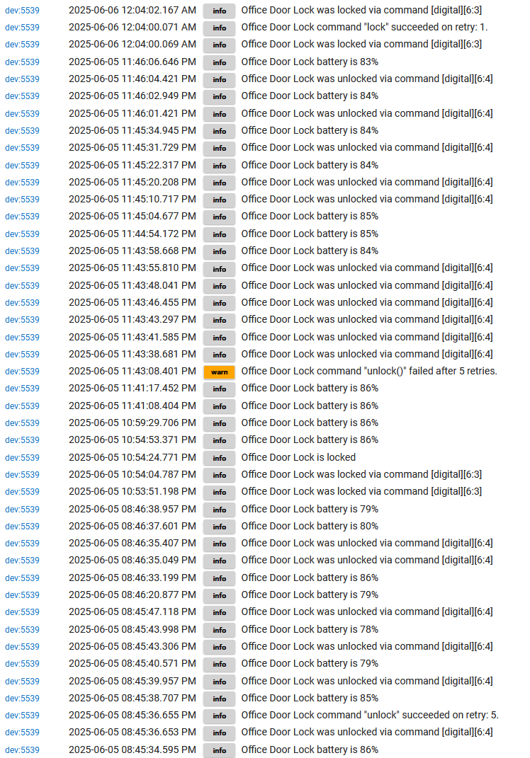

[C8P ZWJS - 2.4.1.177] Lock Retries
@bcopeland This may be up your alley.
I've enabled "Command Retry" on all my devices and that has been a god-send--things work SO much better now. And, while retrying is involved, I am inclined to think this is NOT an issue with the retry process.
Before the "retry" feature, whenever more than a few devices were changed at once, a number didn't respond. Now that I've enabled "retry", they almost always get properly set (which is great)--but there are indications that the hub isn't receiving the expected response to tell it that the device did what it was supposed to.
I wonder if the "Beaming" process is preventing the hub from receiving messages from the devices for a period of time?
In looking at the logs, a number of devices that DID process the command show as "failed after 5 retries". It's very apparent with my 2 Yale locks because they beep every time they receive a command.
When I arrive home and turn on a number of lights along with unlocking the doors with the Yale locks, they unlock immediately but continue to beep many times after that (and often show as "failing" after 5 retries).
I decided to run a test tonight while monitoring the logs. When I just tested it by doing one lock, the first time I tried one of the locks it beeped/retried many times. But, after that, it seemed to work very well--locking/unlocking and beeping just once.
I then tried the other lock (capturing logging this time, see below)--it beeped twice (once upon the initial command, which worked--then again when the retry came through) before it registered the action completing on the hub. This was with a nearly idle hub, as not much else was going on during this test.
Here's the z-wave log for the second Yale lock where it retried a second time unnecessarily (I zeroed out a number of the hex digits, as I didn't know which might reveal security issues):

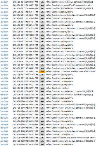

This is a screenshot of the regular logs for this event (at the top) and previous ones that show a lot more retries:
Note that on my other (Schlage) locks, they don't beep like the Yale locks, but they can take a very long time to register their changed state even though they, also, seem to actually effect the desired action right away. Locks seem to be the most troublesome devices, as related to this issue.
Can you tell if this is an issue rooted in the SiLabs firmware or if there's something else going on?
Thanks!
