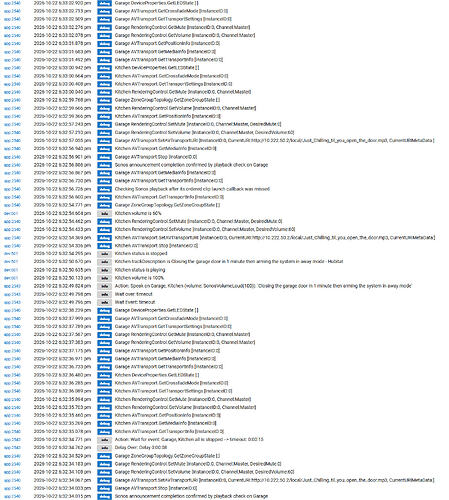

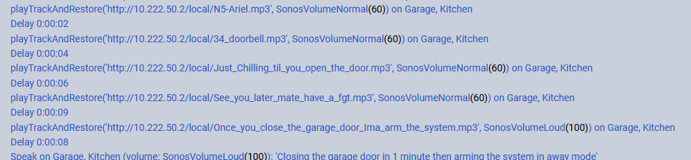

Things are better with my Sonos speakers after recent updates--but I'm still having "missed" and "delayed" sounds at times (somewhat frequently). I created a test rule to test and try various things.

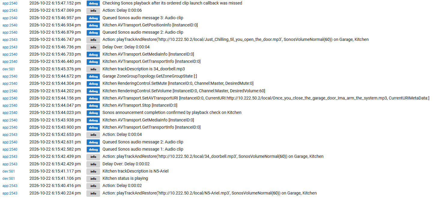

I'm noticing some (in computer terms) notable delays in when things happen in the Integrator vs. when the sounds are sent--which may be contributing to the issues. Also, the Kitchen device seems to be debugging properly, but I'm not seeing the Garage showing up in the logs.

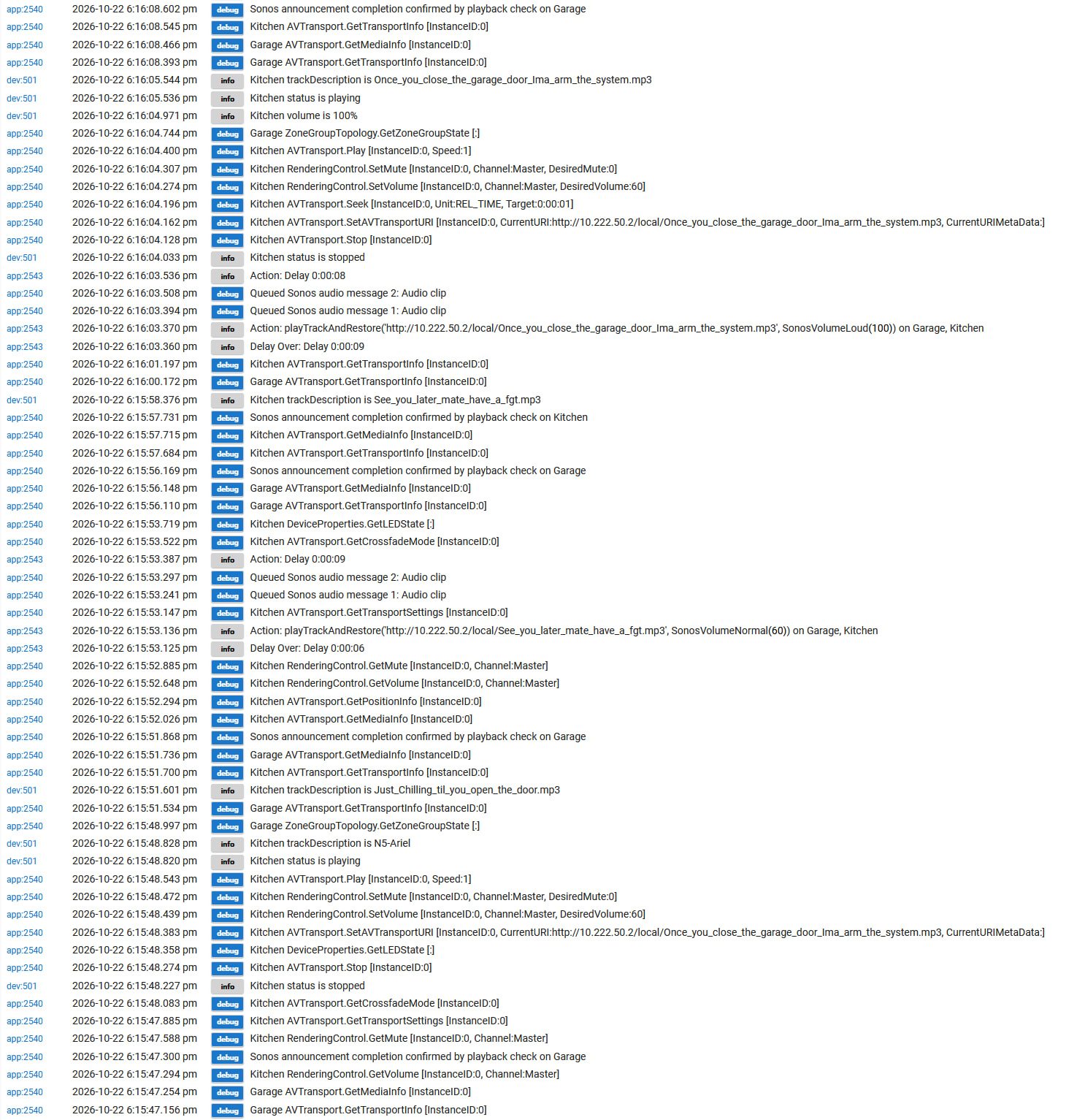

Here's an example--the sounds all came out, but the last 1 or so was delayed coming out of the garage. And, while I put delays between the sounds, the speakers seemed to be lagging the RM rule commands by a notable amount.
I wanted to show you these logs first--in case you had some insight for me. Next, I plan to try adding a "wait for event" on the speakers going to "status=stopped".
For the following rule actions:

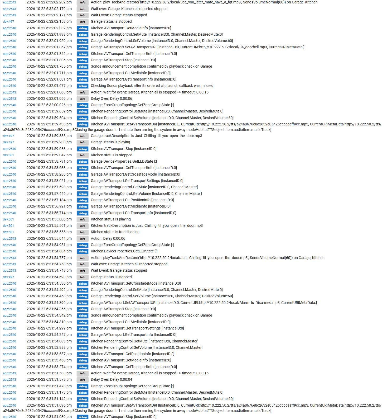

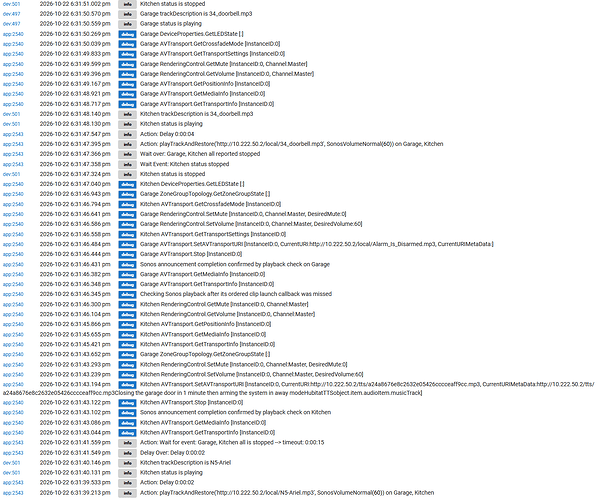

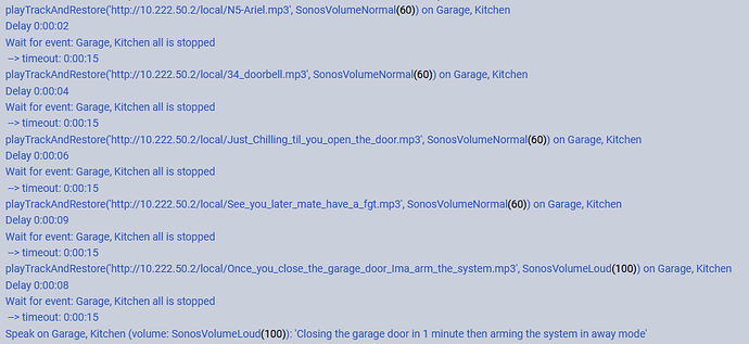

Now, these are the results with those waits added (below):
This time, the "See_you_later_mate_have_a_fgt.mp3" sound only played about halfway through and stopped.

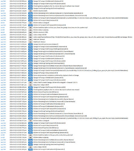

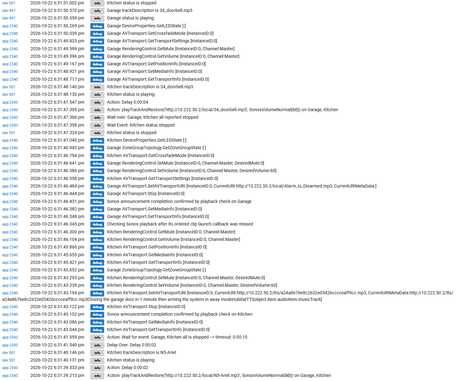

Note that some of the "Wait for status=stopped" events towards the end timed out after 15 seconds without both speakers going to "stopped" (the sounds are nowhere near that long--all well under 10 seconds).
And, the updated rule:

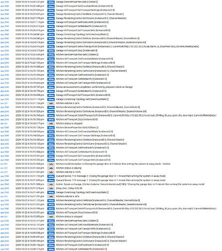

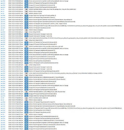

After trying some additional things (I set up variable waits to 30 seconds), I was getting wait timeouts. It appeared that the Garage device didn't respond. It's odd, because the Garage device wasn't logging changes, either. Not sure why. It's identical to the other devices (and has both description and debug logging enabled).
