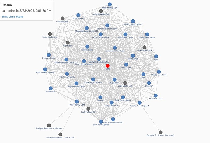

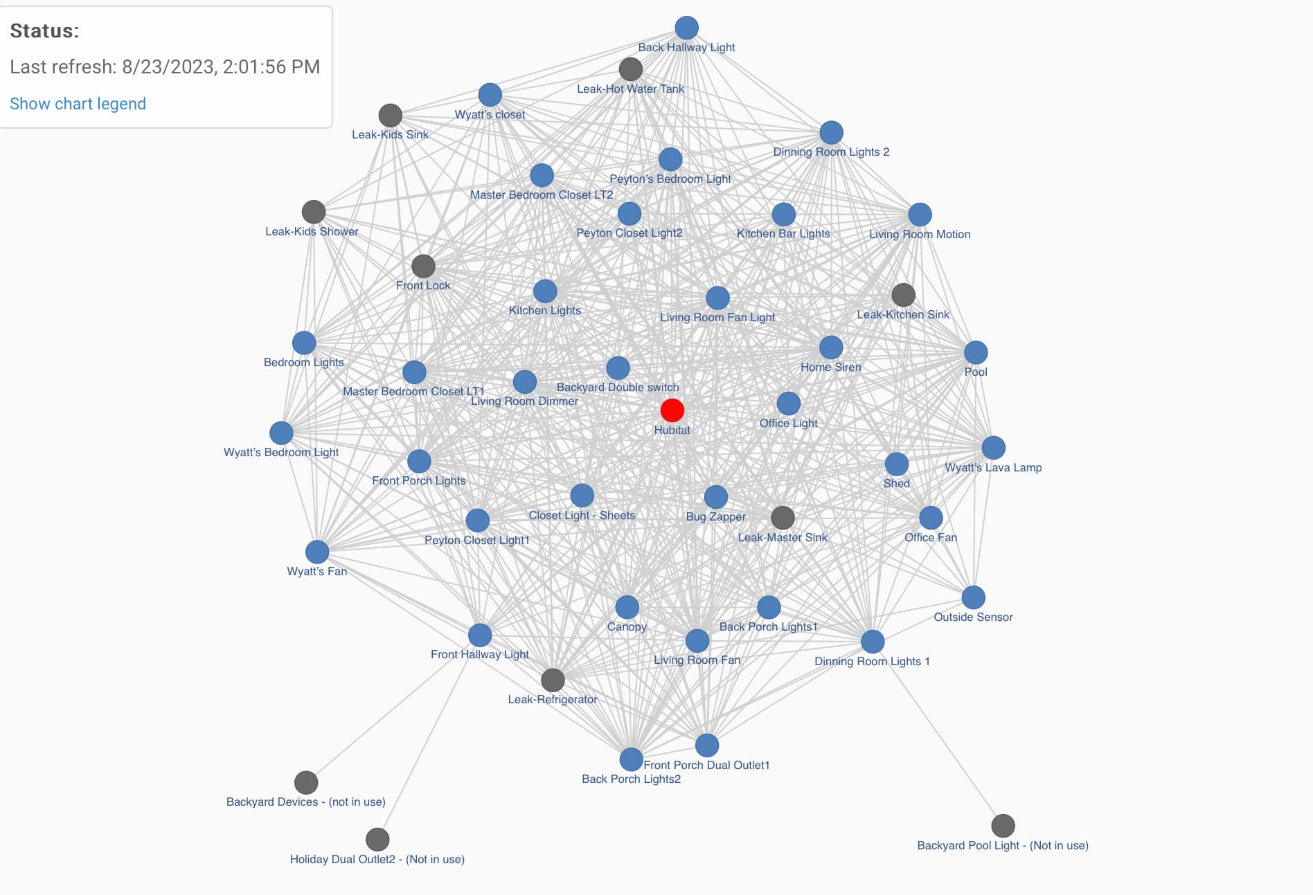

  2. Can you post your Zwave Mesh details page so we can see how it looks when it is working —I will post this at the bottom.

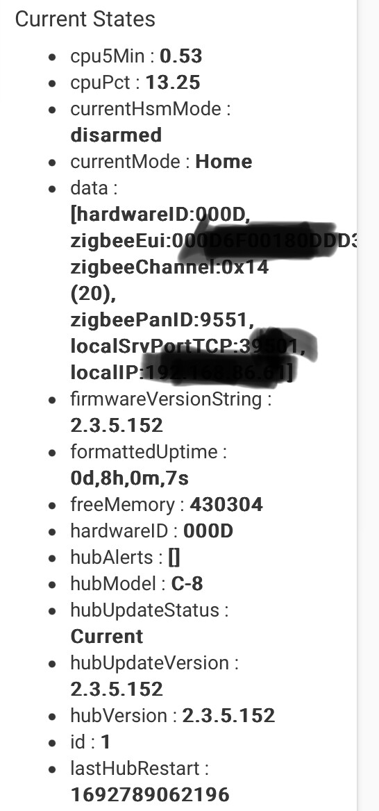

  4. Do you know what the memory usage on your hub is like? I have attached a screenshot below that includes the free memory.

Monthly may not be to bad if your hub is very busy. Looking at your Zwave mesh image it does seem to be pretty busy .
I was actually thinking about the Zwave details page and not the mesh graphic. I was looking for ghosts, but that does look like you have a few devices disconnected though. Are those devices not used. You may want to exclude them if they are not plugged in to contribute to the mesh.

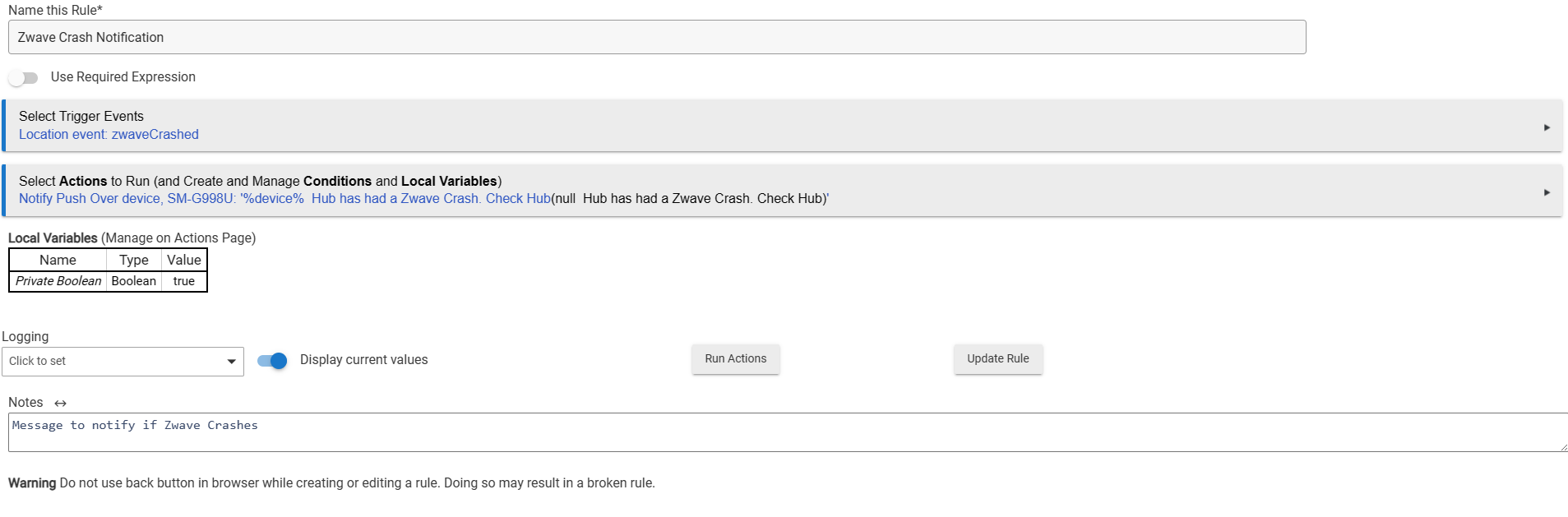

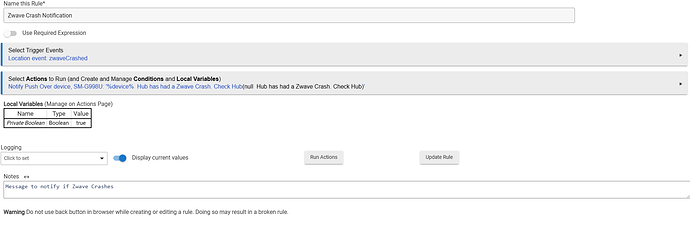

You may want to put a RM rule in place to notify you if the Zwave Radio Crashes. An example of that is below. Not much to it.

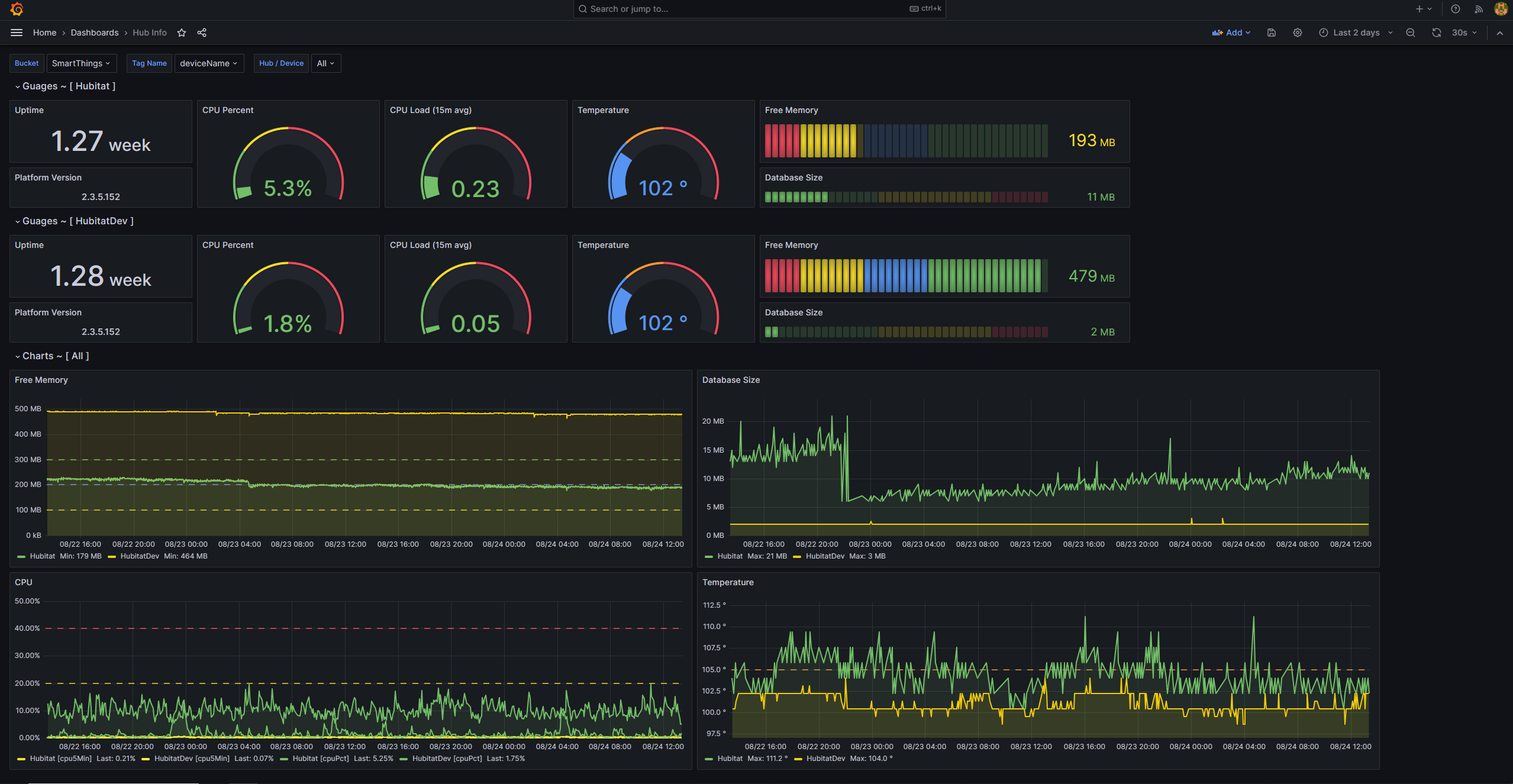

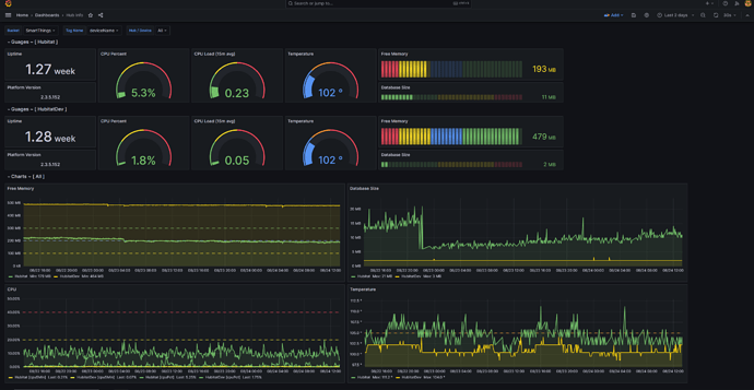

The image for the HubInfo device driver just shows momentary information for memory usage. What would really be helpful is to know what it is like just before the zwave radio crashes. Low memory has been found to be related to radio crashes. You can track this a few ways, but I use Influxdb Logger, a InfluxDB, and Grafana. You technically don't need a always on computer as you can get free cloud accounts for InfluxDB and Grafana.
This Grafana dashboard shows my hub's current state over the last 2 days. My memory on my prod hub starts around 490mb after reboot, but then drops rapidly for about 24 hours and then starts to level off.
From my experience very older generation hardware can be problematic. If you have anything that isn't Zwave Plus(zwave 500) I would suggest working on replacing it.

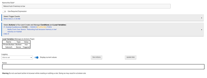

Last thing you may want to do is enable reboot and the HubInfo driver and then setup a rule that will do a reboot if the freeMemory metric gets below 100MB or so. Here is another rule I wrote for that.
