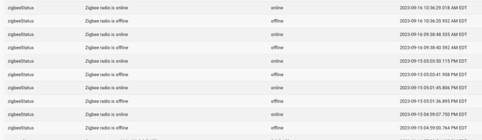

Hi All, not sure if this information will help or not. The story is that I have recently changed the internet provider but missed changing the IP address in the network settings for Hubitat. Hence I didn't have any connection and Hubitat hub and cloud for a couple of days due to the above.
Interestingly, while there were not any issues with my user experience (apart of not getting the notifications when away from home) I found that the zigbee radio did not switched off/on any longer during those couple of days. At least this is what the logs showed and besides that not anylonger zigbee devices being taken out. Once again not sure which is the explanation or if this bit of information helping in any way.
